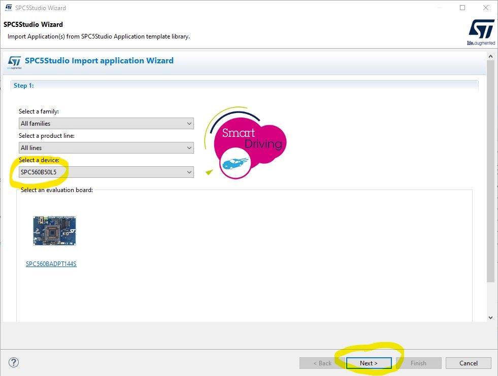

‎2021-03-02 11:29 PM
Hi Ali,
the aim of SPC5Studio is to provide reference code in order to show how to face some issues. The same reference code is generally available for a lot of platforms/cores, but we do not guarantee the full coverage. In your case, for example, the Bootloader test application is available for SPC560B54, but it is not available for the SPC560B50. In any case, you can use the Bootloader test application to understand the mechanism that we use to jump from the Bootloader to the application. Since the aim of jump is generally to run a new firmware that will re-initialize the core, before the jump you must be sure to disable all the drivers previously enabled by the Bootloader, disable the interrupts and move the core in DRUN mode.
About the wizard, if you want to see all the examples available for SPC560B50, you can run the app wizard and filter the application by core, as shown in the picture below.
Regards,
Luigi
