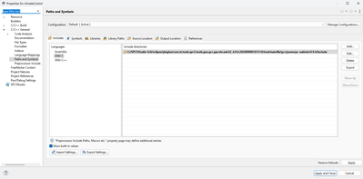

I have installed SPC5 Studio version 6.0 on my Windows 10 PC and compiled sample code.
When compiling the project , i got below warning/issue "Type 'uint32_t' could not be resolved"
Q1: Can you give the solution for this?

Thank you so much for the answer. It really helped.
For others to refer to his solution, you can refer to the below screenshot. |
I added only one directory and it resolved:
C:/SPC5Studio-6.0/eclipse/plugins/com.st.tools.spc5.tools.gnu.gcc.ppcvle.win32_4.9.4.20200908161514/toolchain/lib/gcc/powerpc-eabivle/4.9.4/include
