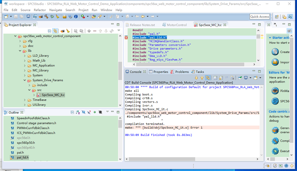

there's problem when trying to build the project (Regardless which of the Web Motor Control Demos I choose).0690X00000ApTKCQA3.png
The steps I made are:
1.) Import samples from application
2.) Choose one of the motor control applications
3.) Generate the SPC5 Application
4.) Build the SPC5 Application
The last step generates following error message:
./components/spc56xx_web_motor_control_component/lib/System_Drive_Params/src/Spc5xxx_MC_it.c:48:21: fatal error: pal_lld.h: No such file or directory
 #include "pal_lld.h"
Which is a bit strange, since I didn't make any changes to the configuration.
Can you please help?

Hello ,
1) MCTKLIB 1.1.0 is not compliant with SpcS5studio 5.8.1-Diadem
 There is Change Request to update the library .
2) MCTKLIB 1.1.0 is compliant with SPC5Studio 5.8.1 (Old Version)
http://mirrors.spc5studio.com/5.8.1/
you can use it without updated RLA components.
3) http://mctkcust.spc5studio.com is compliant with the last version but you need some credentials.
to be asked in credentials@spc5studio.com
Best Regards
Erwan
