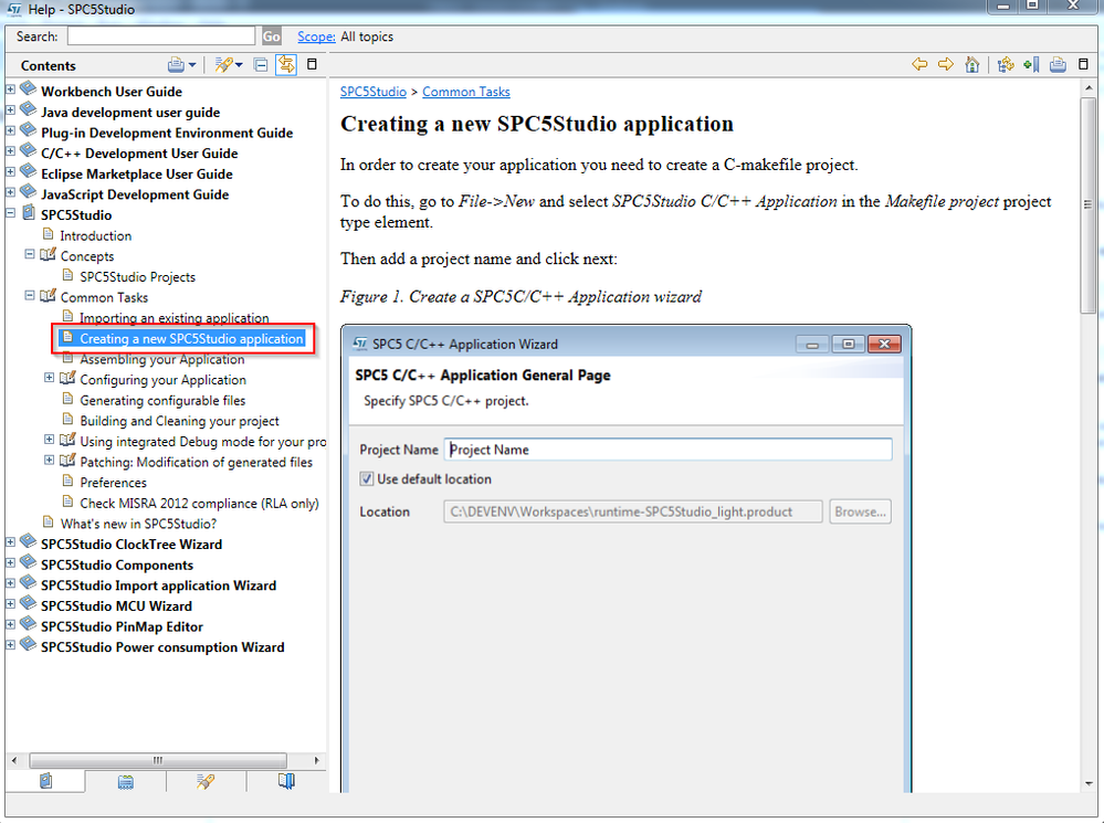

is there a starting guide to start to create a new project? My goal is to port a previous code (a platform written for another micro) in sp5 studio.
gp73
In few word my code is divided in layer, I'll expect to change only the driver layer adapting it to the new micro.

Hello ,
SPC5Studio is an eclipse CDT Environment based on components.
we have 2 types of drivers :
==> RLA = Register Level Access
==> HAL = Hardware Abstraction Layer
is it the same family SPC56/SPC57/SPC58 ?
In the Help Section,
you can find some useful information
Best Regards
Erwan

No is not the same family, is another microcontroller (not ST).
But I can reuse what I already developed because is hardware independent.
