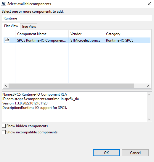

SPC5Studio provides a component called "Runtime I/O" which implements the low lever software to enable printf().
Add "Runtime I/O" component to your project, configure it (which seria port to use) and use printf().

Thank you for your reply. I don't know how to add ​"Runtime I/O" component to my project.
Would you give me a example? I searched "Runtime I/O" in serial enabled project , but found nothing.

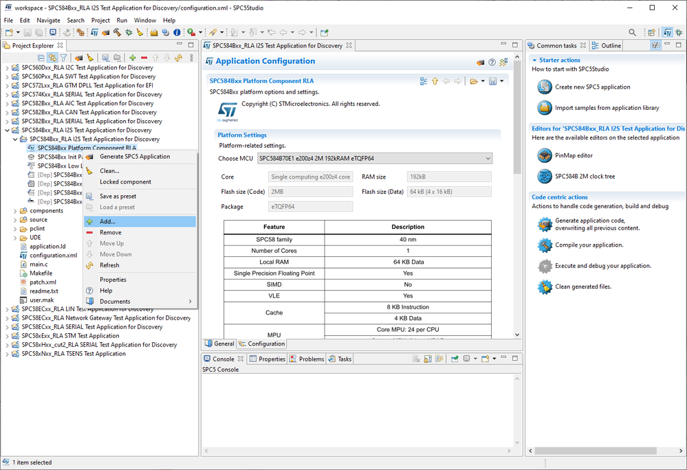

‎2022-11-18 1:56 AM
Select a Platform Component (right click)
Then select Runtime I/O component

Hi Giuseppe DI-GIORE,
Thanks you for your reply. I can add this ​"Runtime I/O" component to my project.

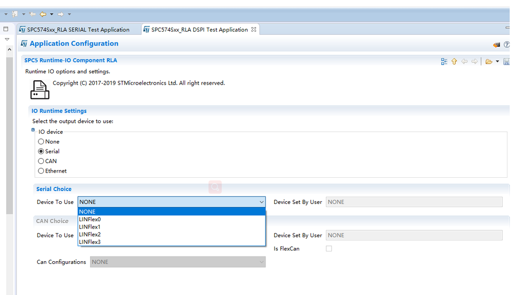

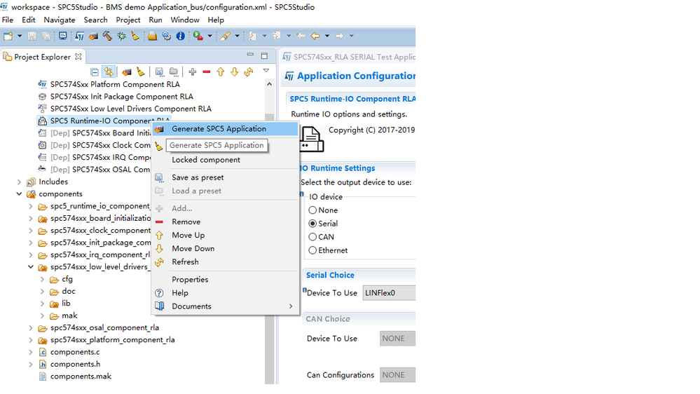

Then I need to select Linflex1 to use like picture. I use SPC574S64E3, I want to use PIN81 and PIN 82 to output data, so what should I do next? I tried to right click on "SPC5 Runtime -component" then select "Generate SPC5 application", it will show an error. attached picture for your reference.
‎2022-12-12 12:45 AM
Configure the serial port using the Low/Level Driver component (selecting the pin you need) and the select the just configured serial port in the Runtime I/O component.
