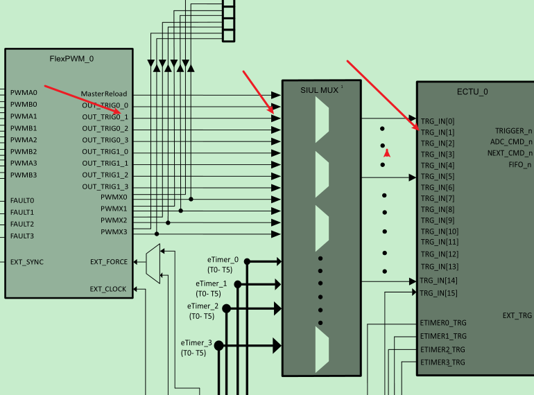

How to configure the trigout signal of the PWM to the TGS module of the CTU module
  • March 25, 2021
  • 1 reply
  • 1446 views

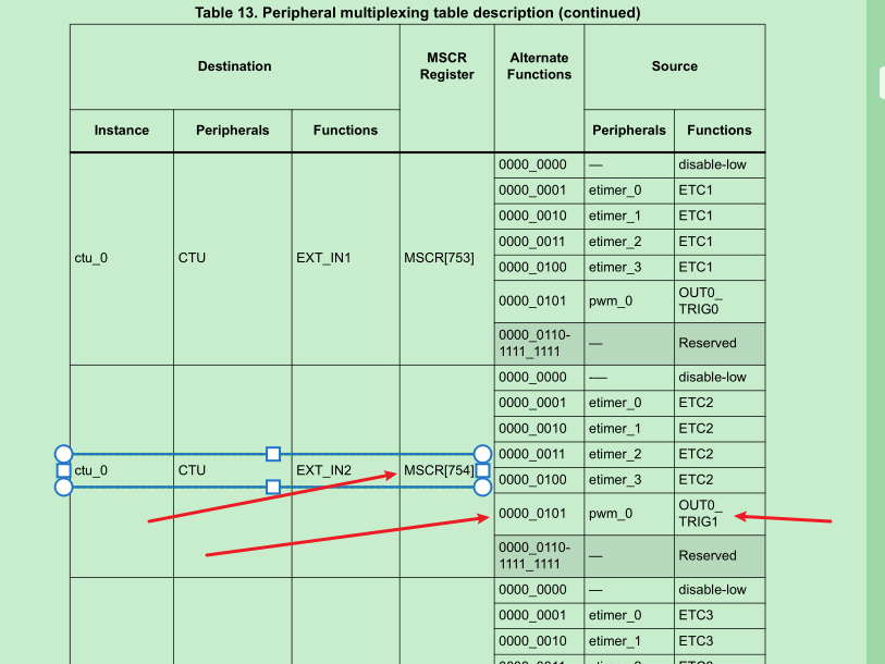

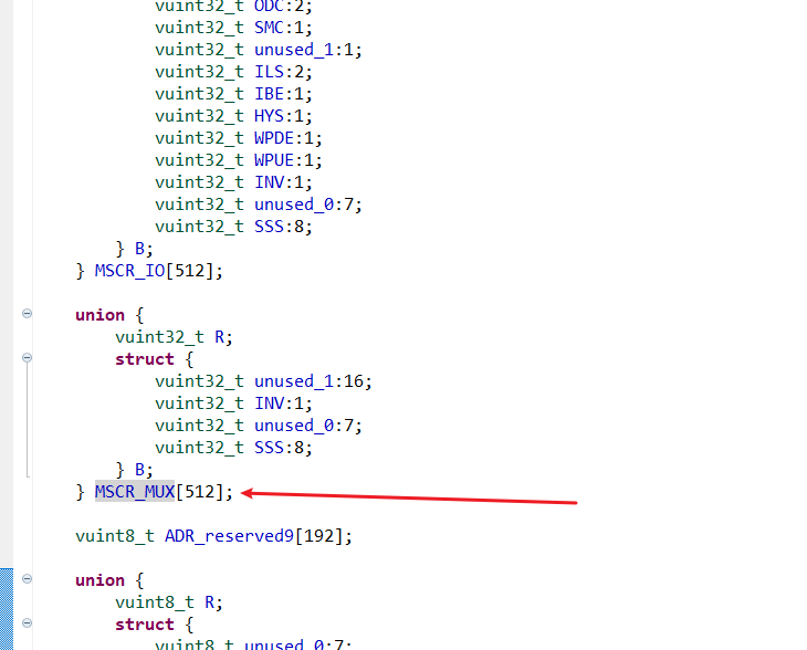

Requirement: The CTU trigger signal from the PWM output needs to pass through the SIU MUX module and then reach the CTU module.0693W000008xr8wQAA.pngFound problem: When configuring the MSCR registers of the SIU2, I found that the description in the manual does not match the registers specified in the official header file. How do I proceed with this configuration, does the manual prevail or does it?

    Hello Capeter ,
    could you give me your device used and device number ?
    maybe your RM is not updated
    Best regards
