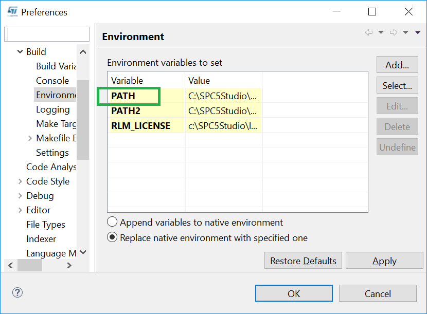

Hello everyone,
I have a problem with the Hightech compiler used in SPC5Studio, I try to explain my issue: on my PC I have installed the SPC5Studio v5.0.0 and the Hightec compiler toolchain v4.6.6.1.
I configured the SPC5 Studio to use the Hightech compiler by adding the following values in the PATH:
C:\HighTec\toolchains\powerpc\v4.6.6.1\bin;
C:\HighTec/licensem
situated under
Windows -> Preferences ->C/C++ -> Build -> Environment  (see the attachment )
I made a test project, builded it and all worked fine, but if I close the SPC5 Studio then reopen it and build again the project (after a clean) the buildin doesn't work anymore; I checked under
Windows -> Preferences ->C/C++ -> Build -> Environment and the values:
C:\HighTec/licensemanager
were missing in the PATH, the only way to make it work is to copy again in the PATH these two values.
Then I tried to add a new variable and copy in it the two values, but it didn't work too.
I'm asking if there is a way to avoid the copy of the values every time I close and open the SPC5 Studio.
Thank you in advance.
Stefano Maccari

Hello Stefano ,
Have you followed
https://community.st.com/0D50X00009bMM5XSAW
Could you confirm that you are in SPC5Studio 5.4.0 ?
it is a bug in SPC5Studio Core
it will be corrected in the next release
in checking the coherency the PATH variable, the PATH Variable is not persistent
1) could you update your system environment in Windows
2) and check Append variables to native environment
    Best regards
                   Erwan

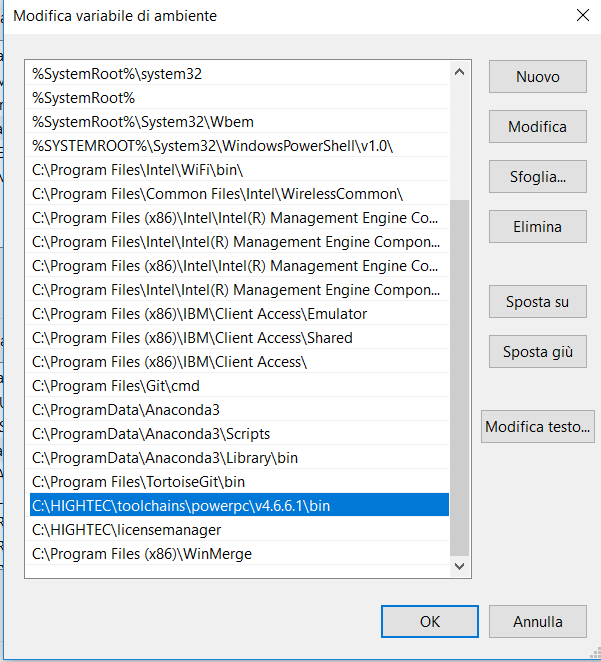

I'm facing the same issue with SPC5Studio v. 5.0.0
I've added the following paths to the Windows PATH environment variable:
C:\HIGHTEC\toolchains\powerpc\v4.6.6.1\bin
C:\HIGHTEC\licensemanager
but still it is not working,
Is there any workaround to overcome the issue without having to update SPC5Studio to the latest release?
Thank you.
Regards
Alessandro

yes ,
Do not remove
C:\SPC5Studio\eclipse\plugins\com.st.tools.spc5.tools.gnu.win32_1.0.0.201706271047\gnutools;C:\SPC5Studio\eclipse\plugins\com.st.tools.spc5.tools.hightec.win32_1.0.0.201306281422\hightec\ppc-ht-eabi\bin;C:\SPC5Studio\eclipse\plugins\com.st.tools.spc5.tools.hightec.win32_1.0.0.201306281422\hightec\bin;C:\SPC5Studio\eclipse\plugins\com.st.tools.spc5.tools.gnu.gcc.ppcvle.win32_1.0.0.201702151735\toolchain\powerpc-eabivle\bin;C:\SPC5Studio\eclipse\plugins\com.st.tools.spc5.tools.gnu.gcc.ppcvle.win32_1.0.0.201702151735\toolchain\bin;�?�?�?
Add in hightec PATH (at the beginning of the String) ..
WARNING : do not remove the next strings which GnuTools PATH and the others Free GCC PATH
Because SPC5Studio is going to check the coherency of GNU TOOLS path
c:\HIGHTEC\toolchains\powerpc\v4.6.5.0\bin\;C:\SPC5Studio\eclipse\plugins\com.st.tools.spc5.tools.gnu.win32_1.0.0.201706271047\gnutools;C:\SPC5Studio\eclipse\plugins\com.st.tools.spc5.tools.hightec.win32_1.0.0.201306281422\hightec\ppc-ht-eabi\bin;C:\SPC5Studio\eclipse\plugins\com.st.tools.spc5.tools.hightec.win32_1.0.0.201306281422\hightec\bin;C:\SPC5Studio\eclipse\plugins\com.st.tools.spc5.tools.gnu.gcc.ppcvle.win32_1.0.0.201702151735\toolchain\powerpc-eabivle\bin;C:\SPC5Studio\eclipse\plugins\com.st.tools.spc5.tools.gnu.gcc.ppcvle.win32_1.0.0.201702151735\toolchain\bin;�?�?
Best regards
