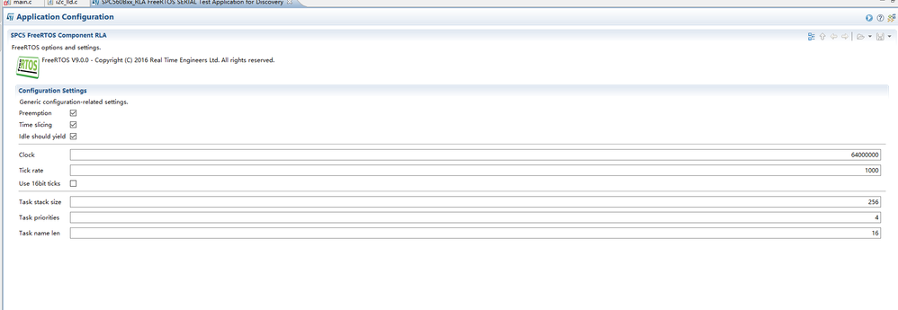

question 2:
My project uses FreeRTOS, each time the code generated, the macro configUSE_TIMERS will automatically become 0. And the Makefile in the compiler parameters will automatically become -O2. Each modification is very troublesome, how can I do?

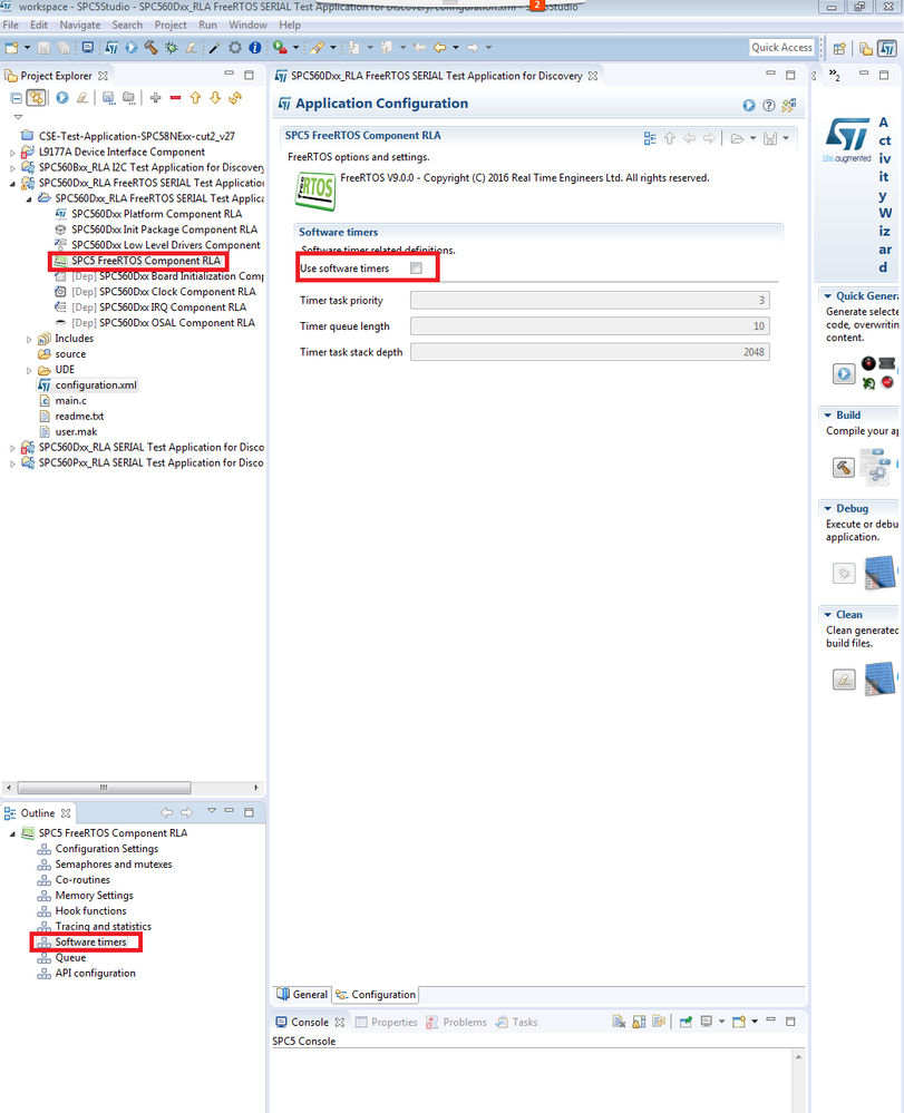

    Question 2:
    the Makefile is generated
    1) -O2 is set in the platform component
    2) for the timer , Go to SPC5 FreeRTOS Component RLA and check Use Software timers
    ==> Save and generate

    Erwan YVIN
    June 27, 2017
    Posted on June 27, 2017 at 09:05
    Hello Guo ,
    You have not clicked on the good configuration settings.
    Click on the outline view to change your panel (cf SPC5Studio Help)
           Best regards
