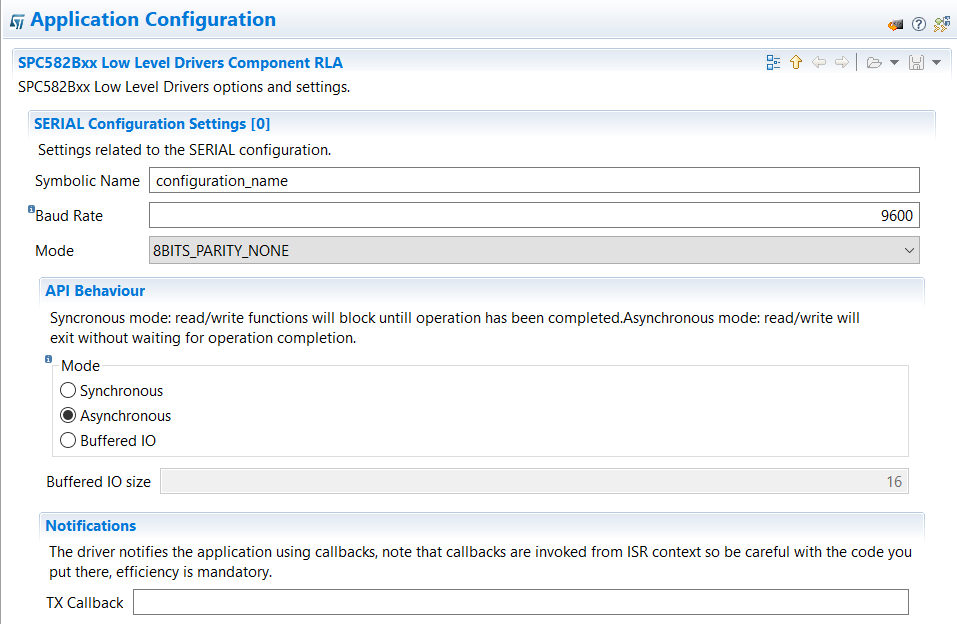

Hi. i'm trying to change my UART baud rate to 9600 in spc582b. by default its working under38600 . i also changed the configuration settings shown below. but my receiving data is wrong. anyone knows?

After setting a new configuration (with a different baud rate),
pass thje 'Symbolic Name' as second argument to sd_lld_start()
sd_lld_start() will apply this configuration.
Regards
