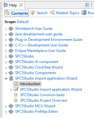

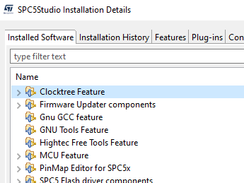

Hi, I'm an SPC beginner, I worked with STM32 before. How can I learn to program through SPC5 studio? What libraries are used? Are any tutorial available? Guide examples?

you can find many information in Help contents for using SPC5Studio:
you can find the library used in menu Help->About STPCStudio->Installation Details:

I attached a simple tutorial to create your own Demo.
Best Regards,
-Olivier
