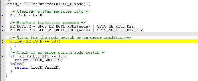

2020-07-29 1:40 AM
my SPC5studio version is 6.0.0,my UDE STK version is 5.0
Solved! Go to Solution.
2020-08-21 7:18 PM
after few days using SPC5studio,I found that the way to solve this problem may not be change your SPC5studio version,you can check your frequency of External crystal , and check whether or not it is corresponding to the Settings of your SPC5studio!!!!

2020-07-29 2:15 AM
i have change the samples code, and i change the platform from SPC560B50L5 to SPC560B50L1,and remove PE_LED1-PE_LED4 in Board Initialization Component. other contents that I have no change.
2020-07-29 2:26 AM
I have test the PIT samples code,but it doesn't work as well.
2020-07-30 5:30 PM
I have already fixed my problem, the reason is my SPC5studio version, I have replaced it with the version which was provided by ST technology support.

Hello ,
For this case , it is often a configuration clock issue.
Which Board do you use ?
Best Regards
Erwan
2020-08-21 7:18 PM
2021-07-28 9:06 PM
May I ask you more details, how you solved the problem.
I am having exactly the same issue.
My target board is SPC582B60E1 (64 pin)
SPC5studio version is 6.0.0 and my UDE STK version is 5.0
Stuck in SPCSetRunMode() in __early_init()
Please share your experience little more elaborate way.
I have checked External oscillator setting as you mentioned. My external oscillator is 40MHz and SPC5 studio setting also have same value.
