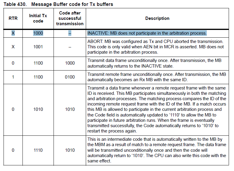

Could you check the Message Buffer code for TX buffers
the Mailbox should be inactive before sending the CAN Frame.
you can use the debugger to check this value.

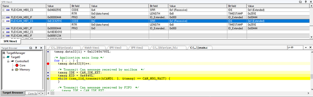

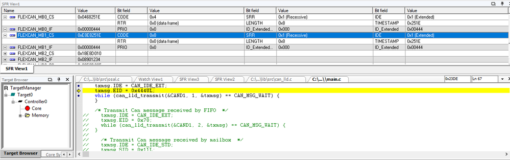

Posted on August 10, 2017 at 10:57
Hello
Erwan,
I am using MB0 for receiving and MB1 for transmitting.
Before the transmit while cycle the MB code shows inactive:
After trying to transmitting it, the code is 0xC which would mean: Transmit data frame unconditionally once.
After a more detailed look it looks like the transmit loop gets stuck when its called the second time, which explains why it says the message buffer is not empty. Still I cannot seen anything on the Tx pin after the first attempt of the transmission.
