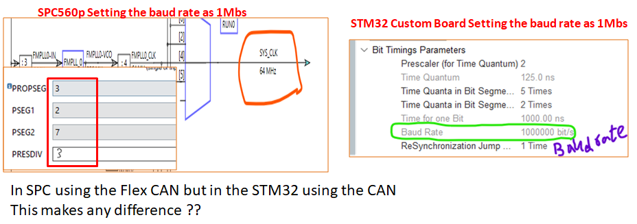

we have been checked the Baud rate for the Both is 1 mb/s and both are little endian only verified with help of datasheet of SPC and STM32 controllers
Saravanan_Mari
Please verify the picture for the Baud rate of the Both the Boards

the baudrate seems on Pictus seems to be correctly configured to 1M. So, the communication between the 2 boards should be correctly executed. Let me suggest also to try to reduce the baudrate on both boards or, if you have available a second Pictus discovery, to try the communication between the 2 Pictus.

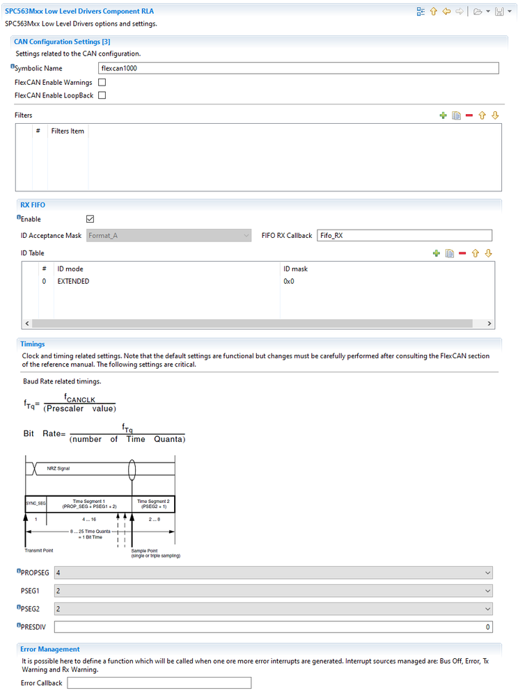

Now, the firmware on the second board that receives the CAN packets from the Pictus Discovery uses the same CAN low level driver used by the Pictus to trasmit the CAN packets. Since the baudrate of the CAN on Pictus Discovery is 1M, the same baudrate is configured also on this second board (please, see the configuration in attachment).
0693W00000AMyYWQA1.pngMoreover, the code used to receive the CAN packets from the Pictus Discovery is the following:

  can_lld_start(&CAND1, &can_config_flexcan1000);
  /* Application main loop.*/
  for (;;) {
where flexcan1000_Fifo_RX is the RX callback of the CAN low level driver used to receive the packets from the Pictus Discovery.
Finally, the CAN low level driver used on the second board has been a little bit patched to receive all the packets sent by the Pictus. You can find it in attachment.
