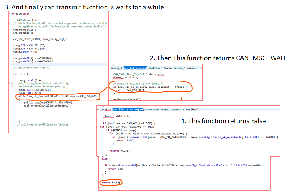

After i start the application the program gets stuck in the transmit while loop:
- while (can_lld_transmit(&CAND1,txmailbox, &txmsg)==CAN_MSG_WAIT){
Its seems like that thecan_lld_is_tx_empty function returns FALSE and it breaks the can_lld_transmit function.
Is the mailbox needs any additional configuration or I configured the CAN clock incorrectly?

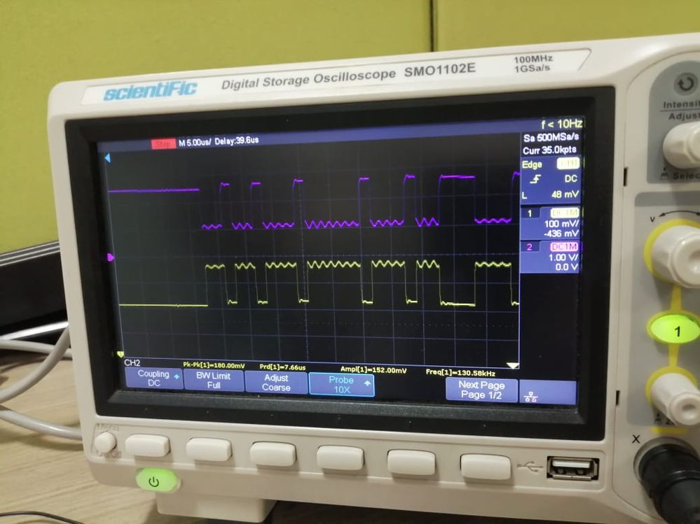

‎2021-04-27 9:17 PM
No just we checking with CRO, The CAN_L and CAN_H Pins are connected to the CRO to check the signals for that only its stucked in thecan_lld_is_tx_empty function returns FALSE and it breaks the can_lld_transmit function. and it never transmits anything on the CAN bus
Can anyone give me a solution for this issue?

HI Saravanan,
if the TX transceiver is not connect with another CAN transceiver, it is normal that nothing is transmitted on the CAN bus. If you check with a state analyzer the CAN pins after the TX CAN transceiver, surely you will be not able to see any transaction. In order to observe the transaction on the pins, you should sample the signals before the TX CAN transceiver.

‎2021-04-27 11:24 PM
But to verify that code is correctly working or not with help of CRO, Meanwhile our team already done the same thing send a message through CAN using STM32 Controller but here we can see that in the code it self it stucked into the function then how it will transmit when we connected with another CAN transceiver
Kindly check the pictures for your reference

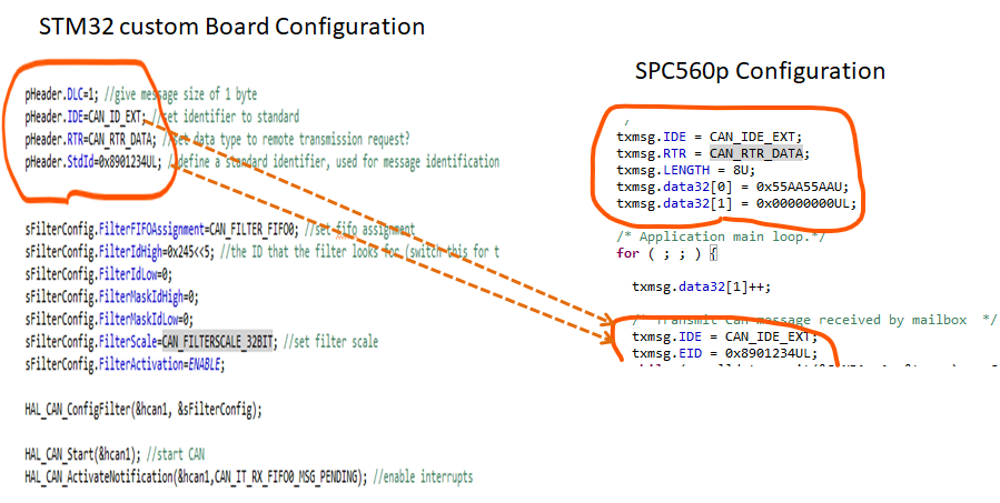

Sorry for that,
i exaplain detailly
We have 2 Boards :
- SPC560p Discovery
- Our Custom Board(STM32L4 controller) and it also having the CAN transceiver
Then Software:
- For transmission we are using your code which is sent as zip file into the SPC560p Disc
- And We already have a Reception code for the STM32 custom Board and which is already working for Reception
- Now the problem is Connected this two board the transmission is not happening same place code is stucked
Kindly refer the pictures
‎2021-04-28 4:22 AM
HI Saravan,
let me suggest to check the baudrate. It is mandotry to have the same baudrate on the 2 boards. Moreover, let me suggest to check also the endianess (ARM is little endian, PPC is big endian).
