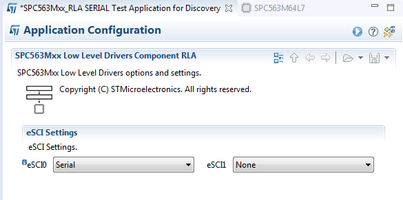

    Marco Perciavalle
    January 14, 2017
    Posted on January 14, 2017 at 12:51
    Hi Erwan,
    no, I use SPC563M-DISP. However, thanks for the support. The example in
    SPC5Studio Application Wizard for SERIAL driver works.
    I've another question to do: I want to create a new program; I import the right libraries, I active Serial in 'SPC563Mxx Low Level Drivers Component RLA' and I select in eSCI0 the 'serial' option; so I generate the application. The program created doesn't work. Why?
    I've noticed that the folder named 'spc563mxx_board_initialization_component_rla' is different to the one of the example: inner files (board.h, in particular) don't declare several component such as PIN_SCI_A_RX and PIN_SCI_A_TX_1. Is this differences to cause this problem?
    Thanks a lot!
    Best regards
    Marco.

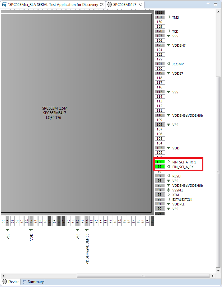

    Marco Perciavalle
    January 15, 2017
    Posted on January 15, 2017 at 18:59
    I've declared missed variables and I've copied the ''main.c'' of the example in my new project: when I flash the board with this program, I obtain the error in the pictures. (pictures from pls UDE)
    note: the example works, instead
    Erwan YVIN
    January 17, 2017
    Posted on January 17, 2017 at 09:48
    Hello Marco ,
    I think that you forgot to enable the associated LINFLEX.
    Low Level drivers RLA and Board Initialization Components (Pinmap Wizard)
    when you use any IP in RLA or HAL you should enable it by the component
    otherwise , the IP is not clocked and can generate an assert.
    Compare the 2 configurations
        Best regards
                         Erwan
