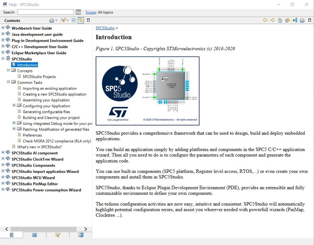

Hello
I am new to SPC5 Studio, please guide me how I can debug my first project.
I am working with SPC5 Studio ver 6.0.0. and have SPC56D_DISCOVERY Eval board.
Thanks
Solved! Go to Solution.

‎2021-03-02 10:49 PM
please, refer to the help integrated within the tool (Help -> Help Contents). There are specific sections dedicated to SPC5Studio.
Regards,
Luigi
‎2021-03-02 11:52 PM
Hi
Thanks,
I have gone through the help content and faced following issues:
- License error:
- Error with using PLS integrated debug option:
- I have externally used UDE STK window to debug the project and following error is observed while programming.
kindly let me know, where I am wrong.
Thanks
