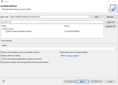

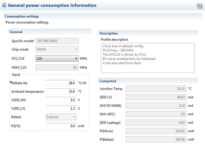

what is the worst case current consumption of SPC584Cx ?

Hello ,
I recommend to use the power conso plugin.
Currently only SPC58xCxx and SPC58xGxx have been created.
Best Regards
