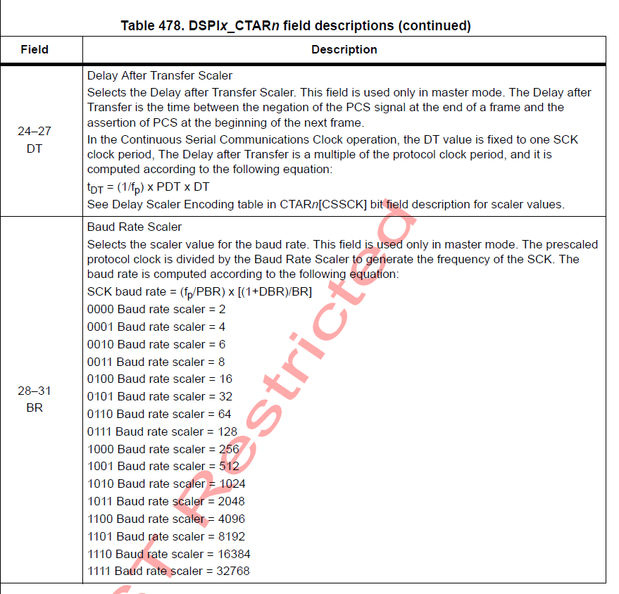

i have a Problem with the Clock Configuration of the SPC570 �C (SPC570S-DISP). I just want to use the External Clock (crystal).
my Configuration:
CGM_SC_DC0/
CGM_SC_DC1/
CGM_SC_DC2 are set to 0x80000000
AC0_SC/AC1_SC/AC2_SC/AC3_SC are set to 0x01000000
My Problem is, i divide the SPI Clock with:
AC0_DC3 = 0x80310000
According to the Reference Manual, the Spi Clock should be 400kHz (40Mhz Crystal / 50 / 2), but it's 200kHz.
Could anyone tell me where my issue could be ?

Hello David ,
AC0_SC/AC1_SC/AC2_SC/AC3_SC is well set to external crystal simulator
the SPI clock should be
(40Mhz Crystal / 50) = 800kHz
Maybe i have missed something.
Did you check your CTAR configuration ?
Anyway, i am going to check with DSPI experts in Autosar team .
      Best regards
                         Erwan
david tomsa
Posted on August 11, 2017 at 11:36
Thanks for your fast answer.
RM0349 Page 473 (Figure 160) say, that the Clock aips_clk1 is divided with 2. 400kHz should be correct.
BR, PBR and DBR are set to 0.
Posted on August 21, 2017 at 11:53
Hello David ,
aips_clk1 is not the good clock.
  • apis_clk is the frequency to access the register not the periph
you have to take periph clock
         Best regards
                     Erwan
