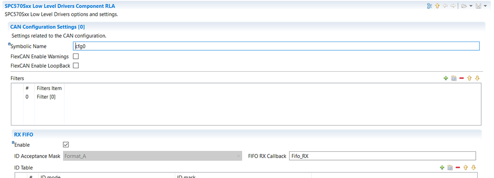

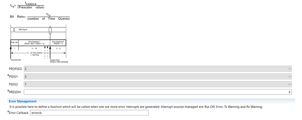

I am trying to setup CAN communication in the SPC570S-DISP dev board. I started with the example available in the SPC5Studio. In the example, internal loopback is enabled, so I disabled it to allow external transmit. I did not change any other settings, as they looked okay to me. In the timing setup section, according to the values that were already set in the example, it has a bit rate of 500 kbps. However, after uploading the code to dev board, and monitoring from a CAN analyzer, no messages seem to be come and the analyzer shows an error. I would like if someone can help me in this matter. I have attached screenshots of the settings and timing setting.
Thank you.
Nisal

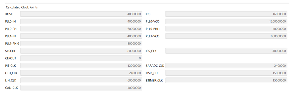

According to the clock settings, the CAN clock is set at 40 MHz,

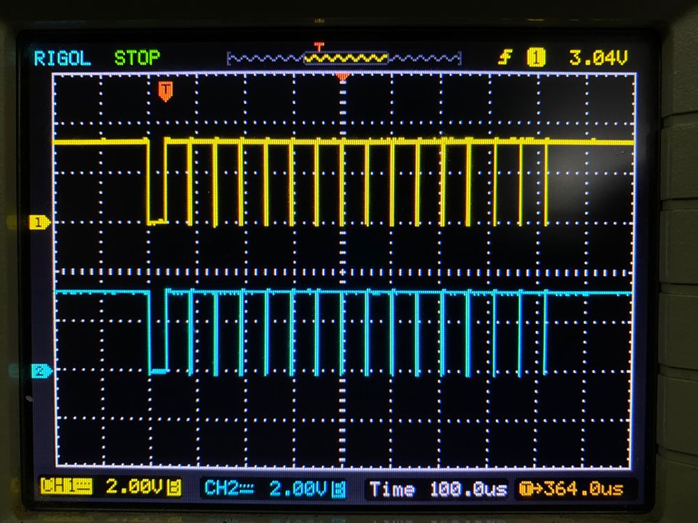

2021-01-15 4:03 AM
Hi Erwan,
Attached here is an image seen from the oscilloscope of the signals CANH and CANL. Please be kind enough to take a look at it.
Nisal

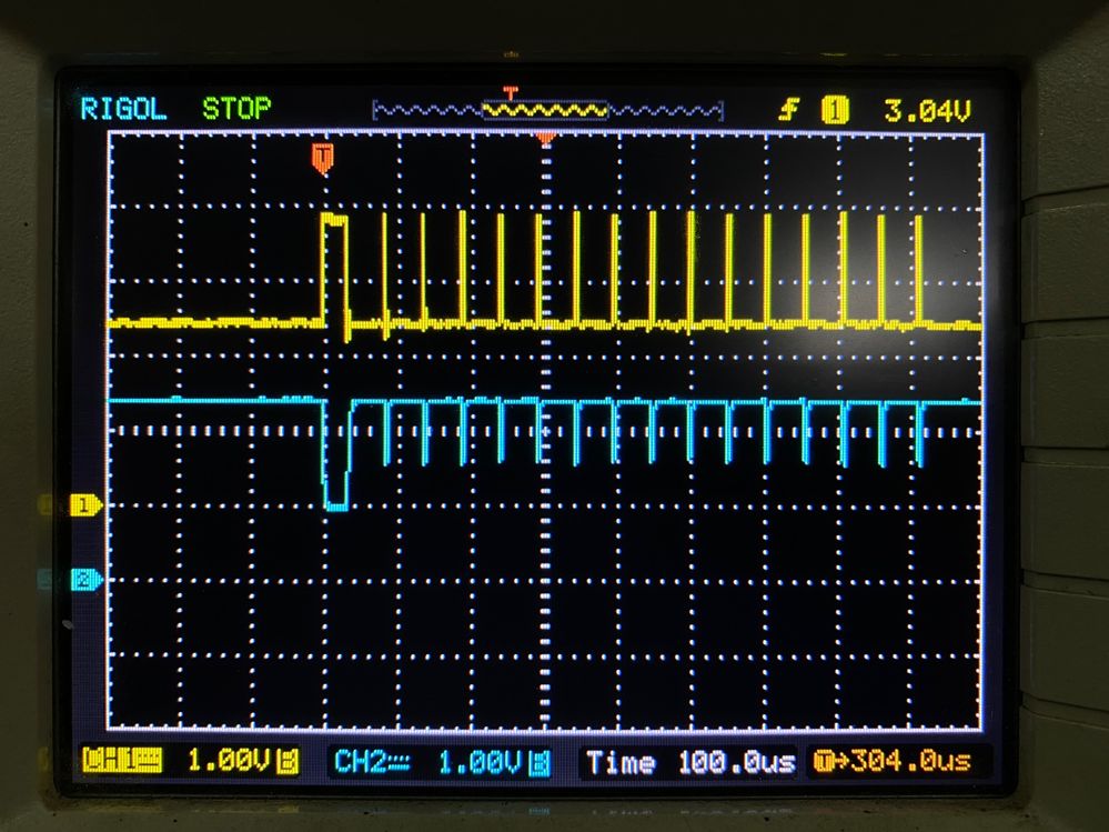

2021-01-15 4:06 AM
Here is capture of the CAN RX and CAN TX signals.
