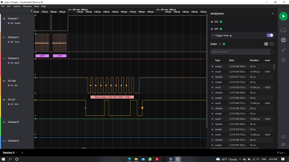

Mr max, im trying to follow the I2C register reset, but when i want to send some data to an address (for example address register 8) it gives me on my logic analyzer 0B0001000 + NACK, so i cant send data without the ack bit. do you know what could be possibly the mistake?
Dear Sir,
It is not easy to help you debug the communication of a microcontroller I do not know.
I can only try to give two general suggestions:
  1. Have you properly set the I2C protocol in the Microcontroller? Speed, Endianess, Start, ACK, Stop times, etc.?

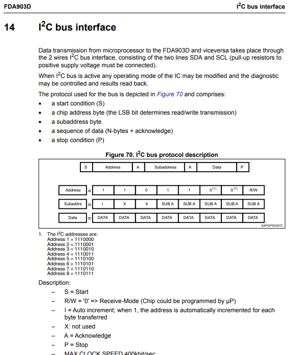

  2. the I2C packet has to be formed according to the datasheet of the FDA903D if you want a response (page 59)0693W00000UnVkXQAV.pngThe packet is 24bits and not 8bits.
Finally, you should already have the source code in AutoDevKit, therefore you can copy from there how to properly prepare the i2C packet.

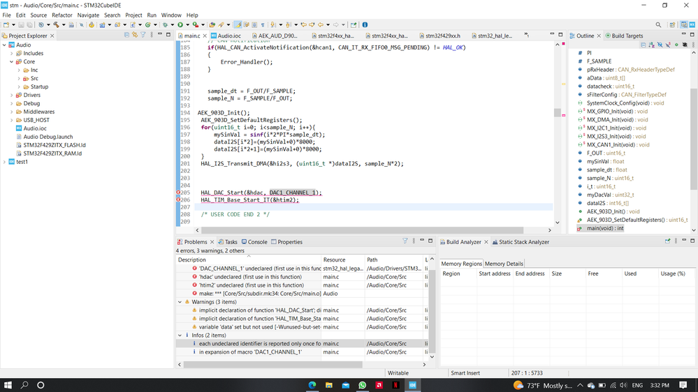

QUESTION 1: is the function that sends play correct?
QUESTION 2: i have error in the last two lines.
Dear Sir,
Unfortunately, I am not familiar with STM32 peripherals therefore I cannot help you with that.
We only support Automotive microcontrollers like SPC58.
Thank you in advance for your understanding.
