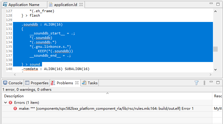

I try to build a test setup with AEK-AUD-D903V1 and AEK-MCU-C1MLIT1 follow the user manual um2719, when I modifed the "application.ld" document, an error was generatered.
.sounddb : ALIGN(16)
__sounddb_start__ = .;
*(.sounddb)
*(.sounddb.*)
*(.gnu.linkonce.s.*)
KEEP(*(.sounddb)) // the error line
__sounddb_end__ = .;
} > sound
I located the error line, if "KEEP(*(.sounddb))" line was deleted, the project will be compiled competely, or failed.
The error indicator was attached. Could you please me to solve this issue, thanks.

I tried to reproduce the error you showed in the attached picture, but without success.

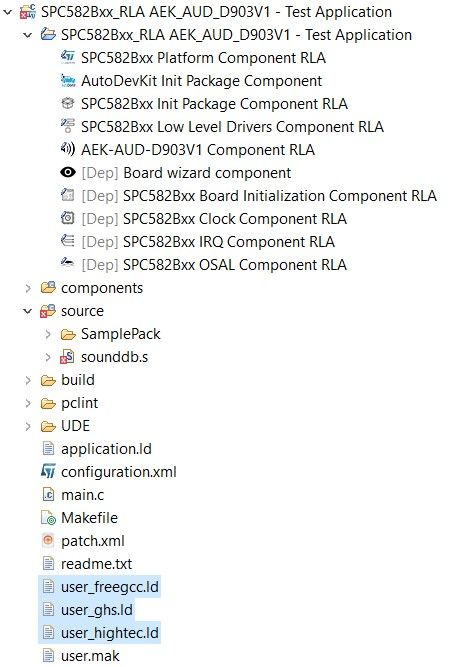

What I can suggest is to import the "SPC582Bxx_RLA AEK_AUD_D903V1 - Test Application" demo project from AutodevKit.
Within this project there are three files called:
- user_freegcc.ld
- user_ghs.ld
- user_hightec.ld
you can use one of these files by copying and pasting the contents in the application.ld file according to the compiler you are using and then recompile the project.
If you are using the GCC compiler, the file to use is user_freegcc.ld
