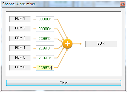

i'm an italian videomaker interested on MEMS mic
I want to record some audio using your Evaluation Kit (STEVAL-MKI126V1 + MKI129V3 connected to my laptop through the MKI138V1
I've installed APWorkbench on Windows 64bit running on Parallels Desktop.
FTDI missing but i can run the app for the STSmartvoice Demo Kit.
What i need is capturing sound from the 4 mics on the 129 board and mix them to a mono file.
The main reason is to get a higher SNR for a better audio quality.
Could you please show me how to send CH3 4 5 6 to only one OUT Channel?
More. I can control the volume only of mic 4 and 5.
It would be great to solve this problem before my shooting next week.
Thanks so much.

Hi Michele,
In order to downmix the 4 mic of STEVAL-MKI129Vx board into a mono stream you can use the embedded processing features of the STA321MP onboard device.
Simply set the pre-mixer coefficients for the ''Mix In 4'' and ''Mix In 5'' to the corresponding hex value for -12dB (ie. 2026F3h instead of the default 7FFFFFh value), this for the PDM3/4/5/6 inputs . Refer to the below picture.
I'm here assuming you're recording the mono stream from the HP output which, by default, gets the audio from the Ch4/5 - that's why this is the only volume you can control.
Let me know if this helps.
Marco

Hi Marco,
thanks for your fast response.
I followed your instructions but i can make mic 4 and 5 working but not the 3 and 6.
Here's my config file. Could you please review it?

Marco VENERI
Posted on November 12, 2014 at 12:45
Michele,
If you're going to use the digital upstream via USB (instead of the HP output) then you should replicate the coefficients I suggested in my previous post on the CH1/CH2 pre-mixer controls.
Jsut to be clear: the headphone jack gets the output from CH4/CH5 of STA321MP whereas the digital upstreaming is done from CH1/CH2.
Marco
