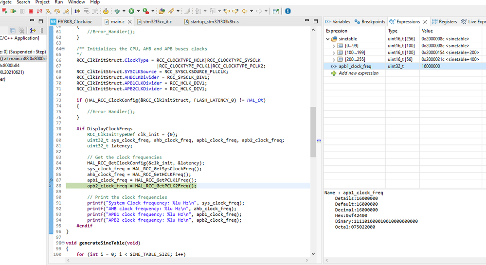

I am including a snapshot of the debug status of my APB1 clock, verifying that am running it at 16MHz

Your interrupt rate is pretty high. 940Hz * 256 samples/period == 240640 interrupts/s. Try to increase APB1 freq. and/or higher code optimization.
Anyway, it will be a waste of CPU cycles. Try timer driver DMA to DAC.
[Edit] A good check that the Core is not overrun is by putting some code in the while loop like a counter and see if/how many iterations per second the IRQ load leaves for normal operation.
hth
