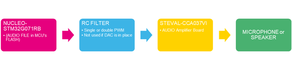

There are a few ways to play audio files with the STM32, in this article we’ll cover 2 very simple methods: using a low pass filter with the PWM output and using a DAC output. On both cases an audio amplifier and a microphone / speaker will be needed to properly output the audio.

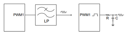

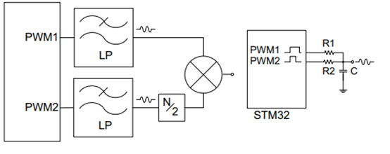

Before diving into the firmware, a few notes about the hardware construction. We’ll aim to have a 16bit resolution in total when using the PWM, this will be done by separated it in 8bit for the MSB (TIM3 channel 1) and 8bit for the LSB (TIM3 channel 2) – to achieve this, the PWM output pins must pass thru a combined low pass filters as shown in the image below – note that there is a relationship between the resistor values, where R2 is obtained by dividing R1 by 256:
Alternatively, for a simple experiment, you can use just the MSB portion (TIM3 channel 1) and have a simpler low pass filter, like this:
The actual values used for this demo were: R1 = 8.2KOhm, R2 = 33Ohm C = 10nF, but the demo was also tested using only the PWM1 (no R2 connection), which provided a good output audio overall as well.

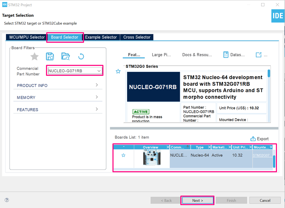

Let’s start by creating a new project for the NUCLEO-G071RB – here it is assumed that you already know how to create a project using a given board as the default, in case you don’t, or you are not sure, here is a quick recap on the steps needed:
Open the STM32CubeIDE
Go to File->New->STM32 Project
Go to the second tab “Board Selector” and type “NUCLEO-G071RB”
Click on the board and then “Next”
Name the project and click Finish

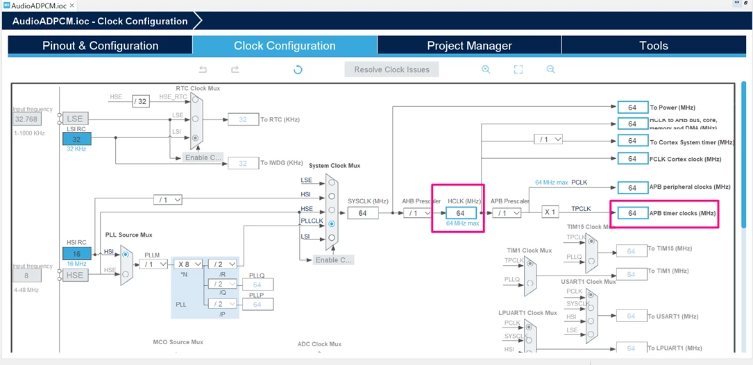

Start by making sure your clock is set as 64MHz, this can be done by going to the “Clock Configuration” tab and asserting the value if needed:

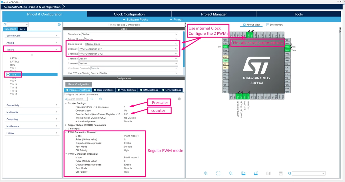

Back to the Pinout & Configuration Tab, add the TIM3 and configure it like this:

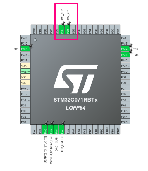

Note that for this demo, the PB4 and PB5 are the pins used for the TIM3_CH1 and TIM3_CH2 respectively:

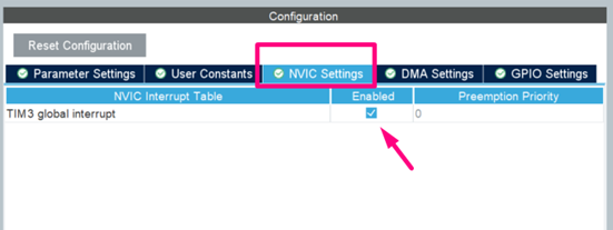

Enable the TIM3 interrupt:

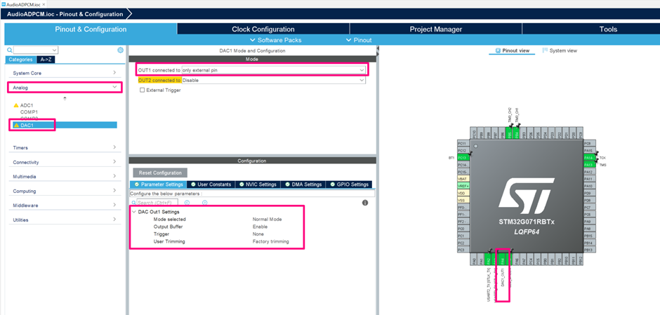

For those how wish to use the DAC instead of the PWM, you can configure it like this:

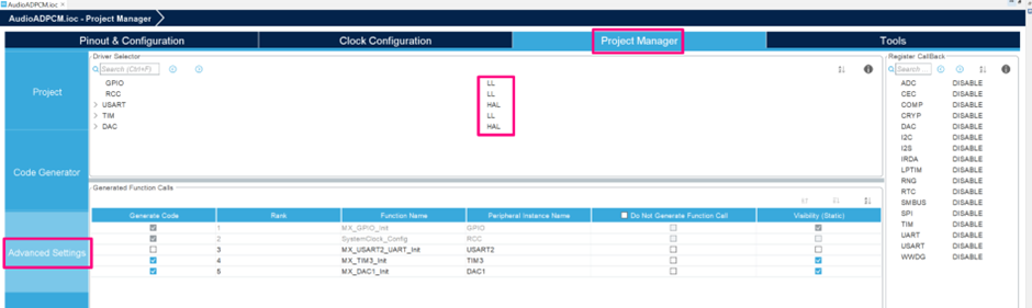

Before generating the code, let’s change the TIM3 and some other peripherals to use the LL instead of the HAL, this is mainly to reduce the application memory footprint and save room for the audio files. Don’t worry, this won’t increase the difficult to implement your code.
Go to the Project Manager Tab, Advanced Settings and select LL for all peripherals, except the DAC and USART (the USART is not used in the application, but you might want to add some debug messages for your own checking):

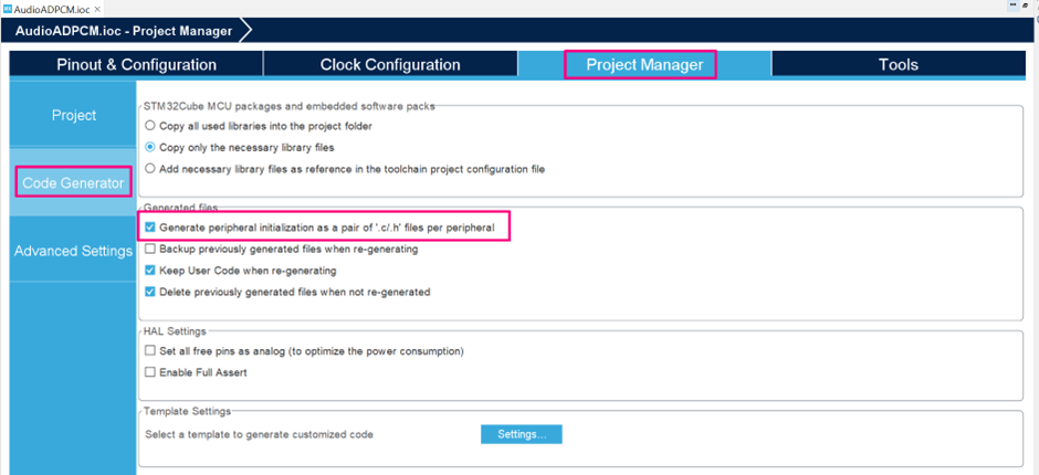

This implementation also used the Code Generator, under the same Project Manager tab to split the source and header file:
Alright, you are all set to generate your project so either use the short cut “Alt+K” or go to Project->Generate Code

    I am following this tutorial to better understand how the timer is configured. I noticed that you explained the calculations of PWM frequency, where f_PWM = 125 kHz, but I did not see this being implemented in the STM32CubeIDE nor in CubeMX in this tutorial.
    Also, how do we know that Timer 3 (TIM3) runs off of APB timer?
