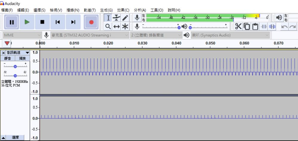

Hi, I followed X-NUCLEO-AMICAM1 QUICK START GUIDE. Nucleo-l4r5zi with X-nucleo-amicam1 has no audio output. Even rebuild project, but got two channels audio noise out. I tried two Nucleo-l4r5zi, but still same situation. Does anyone know about that?

0693W000006I8kHQAS.jpgThis is the screen capture about getting two channels audio noise out.

Hi guys,
After sourcing HSE clock to Nucleo-l4r5zi, it's work.
Thanks.
