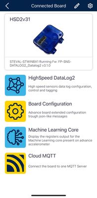

Currently this is my application  as viewed in ST BLE Sensor app (iOS)

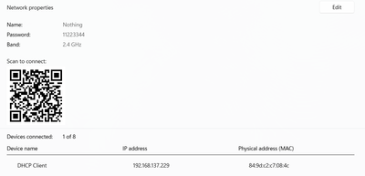

and this screenshot from the computer that a device is connected :
MAC address prefix 84:9D:C2 is registered to Shanghai MXCHIP Information Technology Co., Ltd., ( Google )

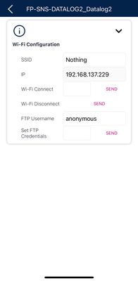

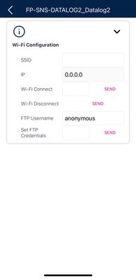

and in my ST BLE iOS App,
So far, I could not get the wifi working as expected,
Issue#1 : Can't configure WIFI in IOS app. Hence, can not verify FTP properly.

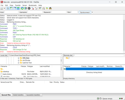

Issue#4: FTP retrieval in this situation, i have only until WIFI connect command and it is connected. Following the ST WIFI FTP connect guide for datalog2, my device is not responsive. Here is the FileZilla screenshot

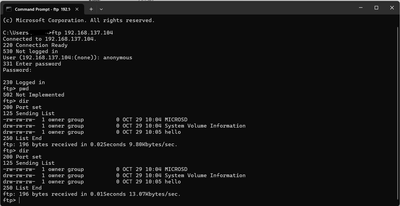

or inside command prompt
C:\Users\xx> ftp 192.168.137.104
Connected to 192.168.137.104.
220 Connection Ready
530 Not logged in
User (192.168.137.104:(none)): anonymous
331 Enter password
Password:
230 Logged in
ftp> dir
200 Port set
550 Bad Directory
ftp>

A small update to the FTP retrieval.

I tested with a couple of boards on 2 different Windows PCs: after opening the FTP, I'm able to send further commands. For example, the following commands are working as expected.

Best regards,
Simone
Thanks @SimonePradolini  it worked as intended. Hopefully i would be able to implement it now through BLE and also the IOS app would be fixed.
