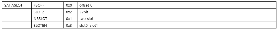

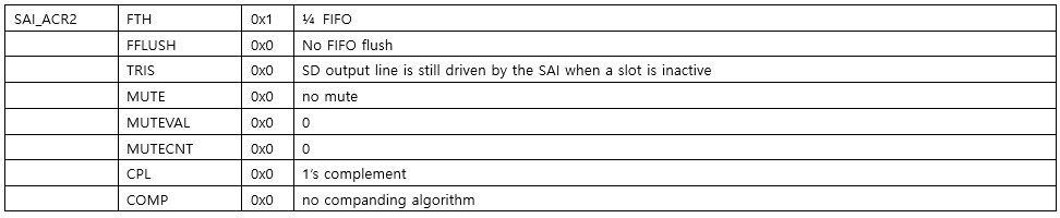

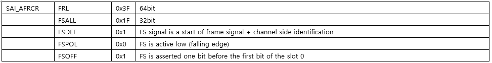

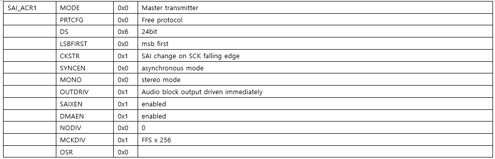

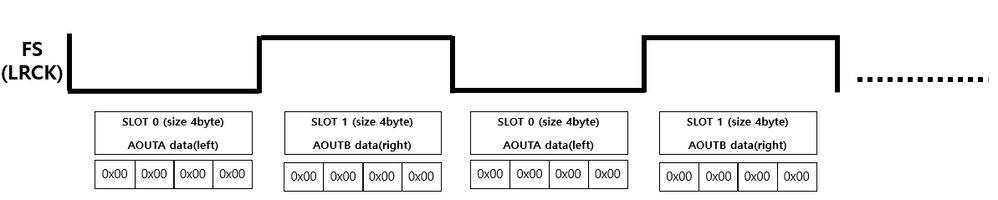

I'm implementing 24bit, 44.1kHz audio out code using STM32H7B3-discovery.
In previous question, i set SAI(I2S format) buffer like below.
0693W00000LyztVQAR.pngI set SAI_A block to output.
And, this is my SAI_A setting.
0693W00000LyzuiQAB.png0693W00000LyzusQAB.png0693W00000Lyzv2QAB.png0693W00000Lyzv7QAB.png
I set tx buffer to zero and BufferOutCtl.buff also filled zero.

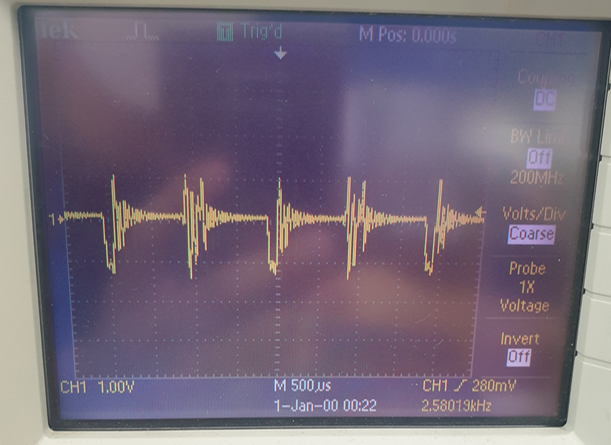

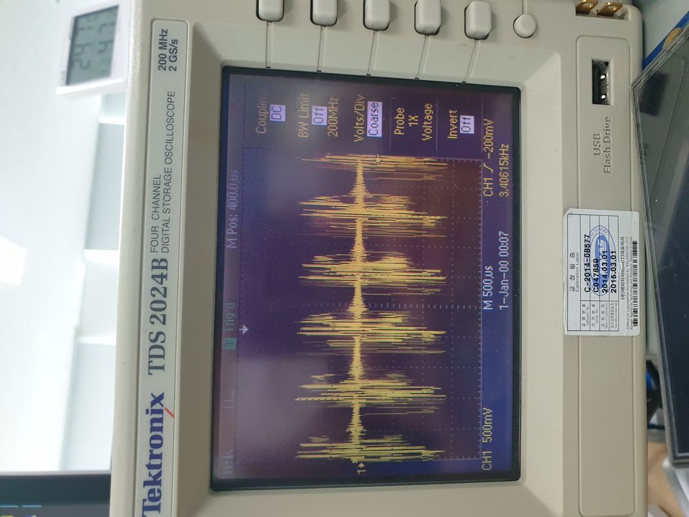

This is my output waveform.

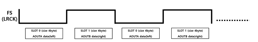

I thought that if I filled the buffer with 4 bytes of data and sent it to dma, it would be as below.0693W00000Lyzw5QAB.pngBut, I got noise waveform.
I checked clock.​
  • LRCK : 44.1kHz
  • MCLK : 11.29MHz

The problem has been resolved.
I missed below code.
HAL_SAI_Receive_DMA(&haudio_in_sai, (uint8_t*) pBuf, (uint16_t) (NbrOfBytes / (Audio_In_Ctx[Instance].BitsPerSample / 8U)))
​My Audio_in_Ctx[Instance].BitPerSample was 24.
I modified this value to 32.

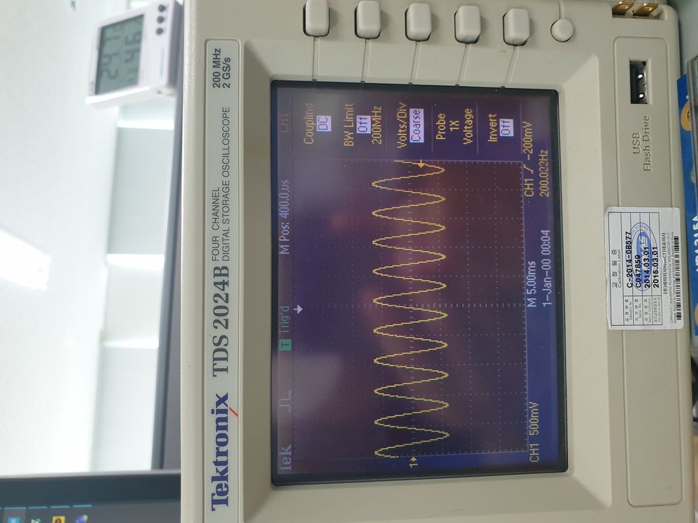

I attach more pictures.
I send input buffer data to output buffer.(100Hz 100mVpp sine wave from function generator)
while (1) {
		if (rx_half_flag) {
			SCB_InvalidateDCache_by_Addr((uint32_t*) &BufferInCtl.buff[0], HALF_TXRX_SIZE);
			memcpy(rx_buffer, &BufferInCtl.buff[0], HALF_TXRX_SIZE);
			rx_half_flag = 0;
		if (rx_full_flag) {
			SCB_InvalidateDCache_by_Addr((uint32_t*) &BufferInCtl.buff[HALF_TXRX_SIZE], HALF_TXRX_SIZE);
			memcpy(rx_buffer + HALF_TXRX_SIZE, &BufferInCtl.buff[HALF_TXRX_SIZE], HALF_TXRX_SIZE);
			rx_full_flag = 0;
		if (tx_half_flag) {
			SCB_CleanDCache_by_Addr((uint32_t*) &BufferOutCtl.buff[0], HALF_TXRX_SIZE);
			memcpy(&BufferOutCtl.buff[0], rx_buffer, HALF_TXRX_SIZE);
			tx_half_flag = 0;
		if (tx_full_flag) {
			SCB_CleanDCache_by_Addr((uint32_t*) &BufferOutCtl.buff[HALF_TXRX_SIZE], HALF_TXRX_SIZE);
			memcpy(&BufferOutCtl.buff[HALF_TXRX_SIZE], rx_buffer + HALF_TXRX_SIZE, HALF_TXRX_SIZE);
			tx_full_flag = 0;
​when i set frame size to 16bit,
  • mx_config.DataSize = SAI_DATASIZE_16;
  • mx_config.FrameLength = 32;
  • mx_config.ActiveFrameLength = 16;​
the waveform is clear.
This is 24bit frame size.
  • mx_config.DataSize = SAI_DATASIZE_24;
  • mx_config.FrameLength = 64;
  • mx_config.ActiveFrameLength = 32;
