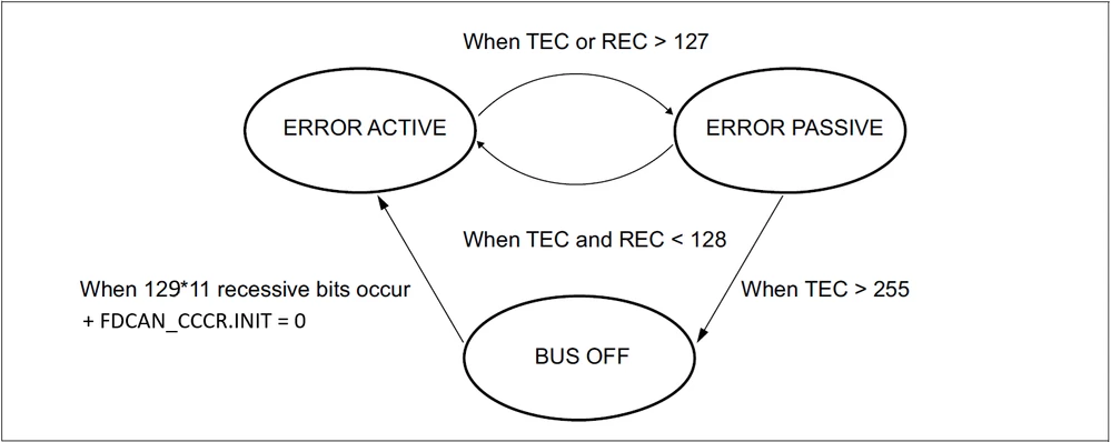

1. Understanding the Bus-Off state in STM32 FDCAN
The Bus-Off state is a protective mode that the FDCAN controller enters when the transmit error counter (TEC) surpasses the threshold of 255, as depicted in Figure 1. This condition typically results from sustained transmission errors on the CAN bus, indicating significant communication issues.
While in the Bus-Off state, the FDCAN module is effectively disconnected from the bus. It cannot transmit or receive any messages. This safeguard prevents further disruption of the network caused by a faulty node. It is important to highlight that the Bus-Off condition is triggered by a transmitter not by a receiver, disturbing the communication. A receiver-only node (listen mode) does not enter this state.
Recovering from the Bus-Off state requires a specific sequence to ensure that the node safely rejoins the network without causing additional errors. Understanding and properly handling the recovery process is essential for reliable CAN-FD communication.
Figure 1. FDCAN error state diagram
The BO bit (bit 7) indicates the Bus-Off state in the FDCAN protocol status register (FDCAN_PSR). When the Bus-Off state occurs, the BO bit is set.
