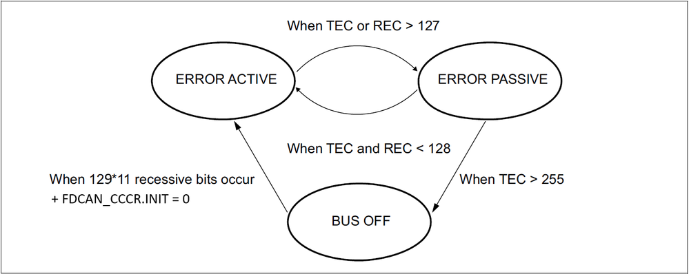

1. Understanding the Bus-Off state in STM32 FDCAN
The Bus-Off state is a protective mode that the FDCAN controller enters when the transmit error counter (TEC) surpasses the threshold of 255, as depicted in Figure 1. This condition typically results from sustained transmission errors on the CAN bus, indicating significant communication issues.
While in the Bus-Off state, the FDCAN module is effectively disconnected from the bus. It cannot transmit or receive any messages. This safeguard prevents further disruption of the network caused by a faulty node. It is important to highlight that the Bus-Off condition is triggered by a transmitter not by a receiver, disturbing the communication. A receiver-only node (listen mode) does not enter this state.
Recovering from the Bus-Off state requires a specific sequence to ensure that the node safely rejoins the network without causing additional errors. Understanding and properly handling the recovery process is essential for reliable CAN-FD communication.
 Figure 1. FDCAN error state diagram
The BO bit (bit 7) indicates the Bus-Off state in the FDCAN protocol status register (FDCAN_PSR). When the Bus-Off state occurs, the BO bit is set.
2. FDCAN recovery method from Bus-Off state
The Bus-Off recovery is the process by which a node on a CAN bus returns to an operational state. It is then able to retransmit CAN frames after its own transmit error counter exceeds the critical threshold TEC > 255. To recover from the Bus-Off state, the FDCAN node must wait through a recovery sequence defined by the FDCAN specification. This sequence involves monitoring 129 occurrences of 11 consecutive recessive bits on the FDCAN_RX input. This monitoring is transparent to the user level, and it is performed at the hardware level. Contrarily to bxCAN, which needs to monitor 128 occurrences of 11 consecutive recessive bits.
The FDCAN peripheral requires software intervention for Bus-Off recovery. This is because the FDCAN interface does not support hardware automatic recovery. Which is not the case with some STM32 series, such as STM32F1, STM32F4, and STM32F7, that feature the bxCAN version with automatic Bus-Off recovery managed by hardware, through the ABOM bit in the CAN_MCR register.
According to the FDCAN specification described in the reference manual, two conditions must be met for the node to recover from the Bus-Off state:
  1. The INIT bit in the FDCAN_CCCR register must be cleared by software after a Bus-Off occurrence.
  2. At hardware level, the node must detect 129 occurrences of 11 consecutive recessive bits on the FDCAN_RX input.
After that, the node can start to transmit on the CAN bus.
