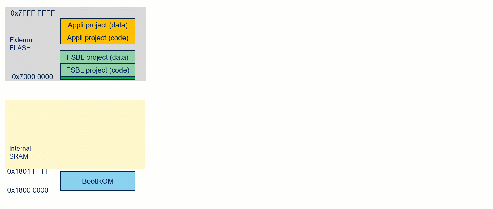

1.1 FSBL and application running from an external PSRAM
In this mode, the FSBL and application are in different addresses of the external flash memory. The boot ROM copies the FSBL from the external memory into the internal SRAM. It’s up to the FSBL to prepare the memory to operate in memory-mapped mode and jump to the application’s location to be executed directly from the external FLASH. The visual representation can be observed in the small animation below:

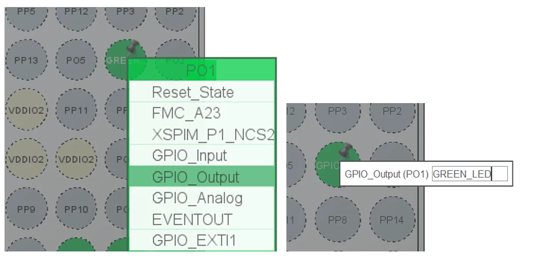

2.1.1 Configure the LED pin
The project needs to configure a few peripherals to work properly, including the green LED, associated with the PO1 and its active HIGH and the external memory connected to XSPI2.
Start by creating a new project using the STM32CubeMX and select the [STM32N657X0H3Q]. Select the option to use the [Secure Domain only].

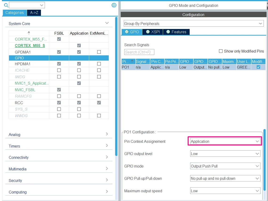

Locate the PO1 and configure it as GPIO_Output and use the label to name it [GREEN_LED].
We need to assign the GPIO to be used by the application.

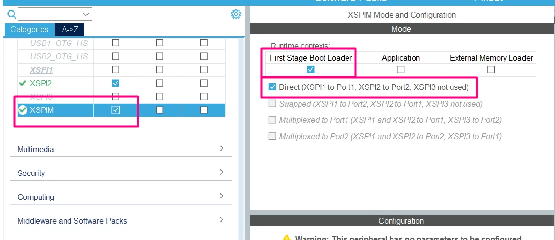

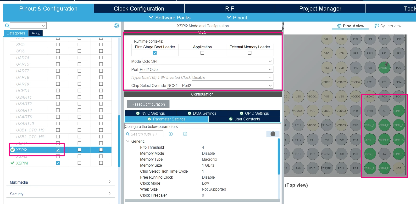

2.1.2 Configure the XSPI1, XSPI2, and XSPIM
Locate the [XSPIM] on the left side under the "Connectivity" menu, and select it to run during the [First Stage Boot Loader] and have the [Direct] mode selected:

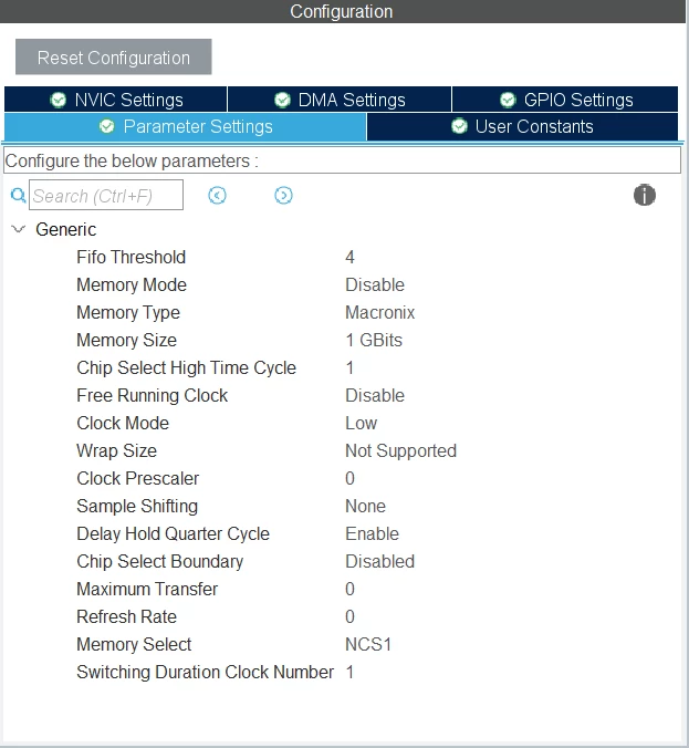

The Octo‑SPI flash memory has the following characteristics: 1 Gbit, 1.8 V, 200 MHz, DTR, read while writing. It’s connected to the OCTOSPI interface of the STM32N657X0H3Q microcontroller on the STM32N6570-DK board on XSPI2. With that information, go to XSPI2 to configure the peripheral according to the hardware available:
As for the [Parameter Settings], look carefully at the image below:

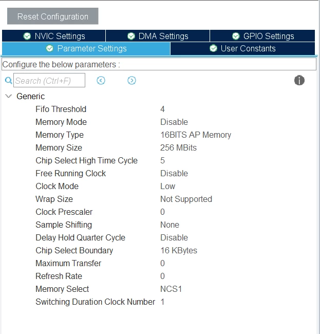

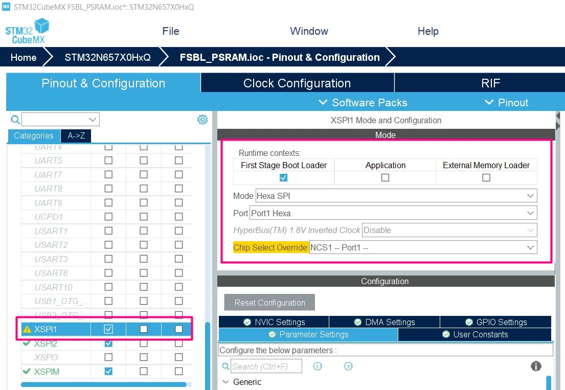

The hexadeca-SPI PSRAM has the following characteristics: 256 Mbit/s, 1.8 V, 200 MHz, DDR. It is connected to the hexadeca-SPI interface of the STM32N657X0H3Q, which is associated with the XSPI1. With that information, go to XSPI1 to configure the peripheral according to the hardware available:
As for the [Parameters Settings], please carefully look at the image below:

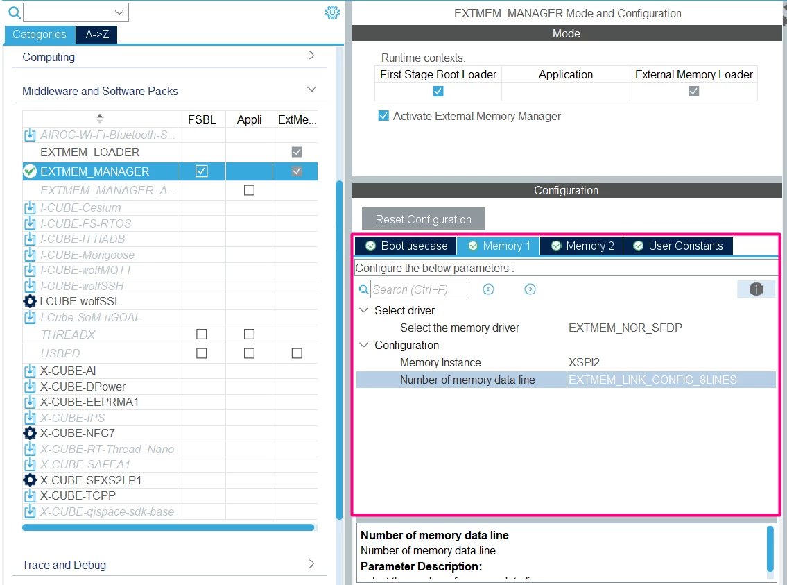

2.1.3 Configure the EXTMEM_MANAGER
The next step is locating the [Middleware and Software Packs] in the [Categories] and expand the [EXTMEM_MANAGER]. Add the [First Stage Boot Loader] and the [Activate External Memory Manager] checkbox, using the following settings:
In the [Memory 1] tab, ensure the as follows:

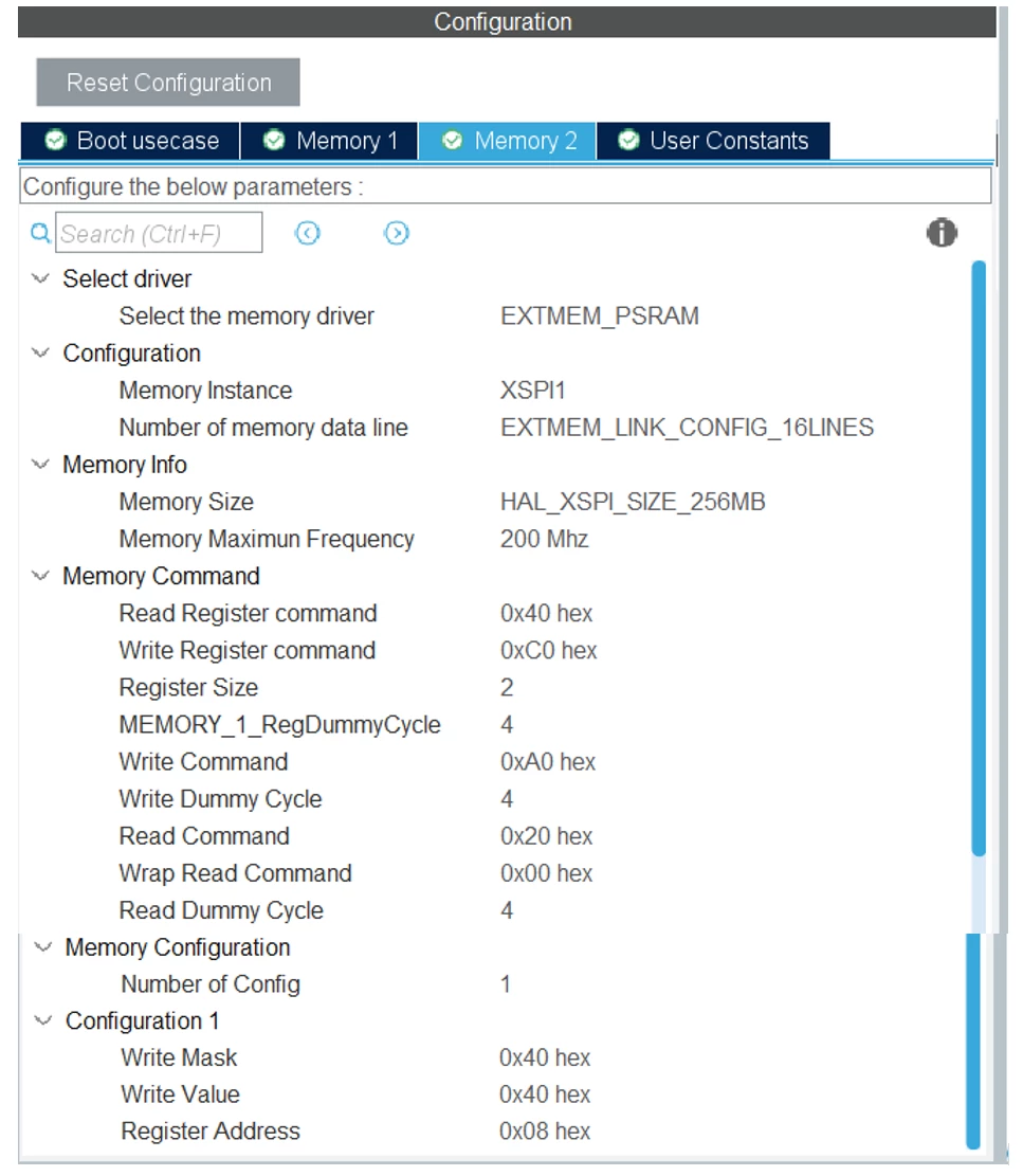

In the [Memory 2] tab, ensure that the configuration is as follows:

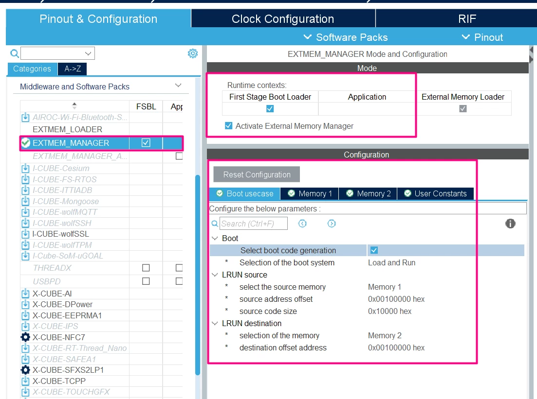

With the memories properly configured, it’s possible to use the [Boot usecase] tab and add the Load and Run selection, copying from the serial FLASH NOR (Memory 1) to the external PSRAM (Memory 2). The addresses and offsets are shown below:

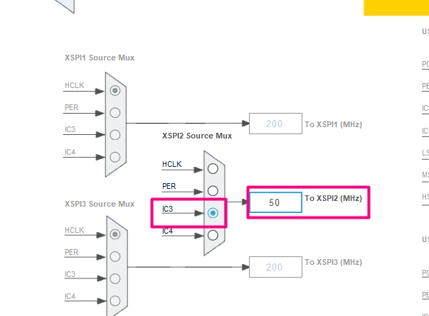

2.1.4 Configure the XSPI clock
The last step for the XSPI is to configure its clock. For this example, we set the XPI clock to 50 MHz. Go to the [Clock Configuration] tab and have the IC3 as the source for the XSPI2 and type 50 and press enter for the clock to be automatically adjusted:

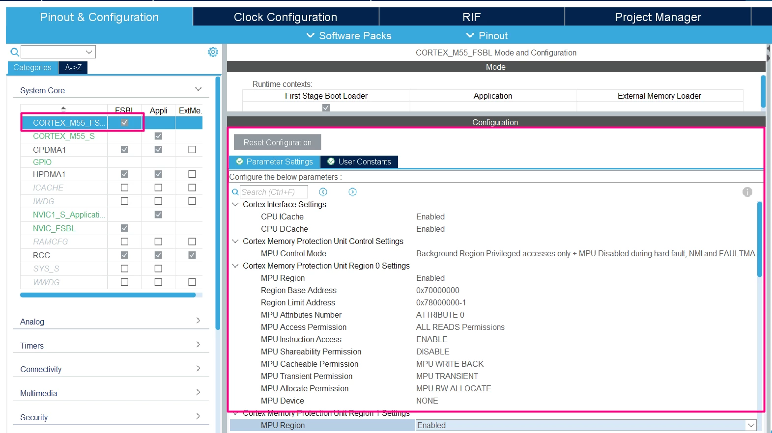

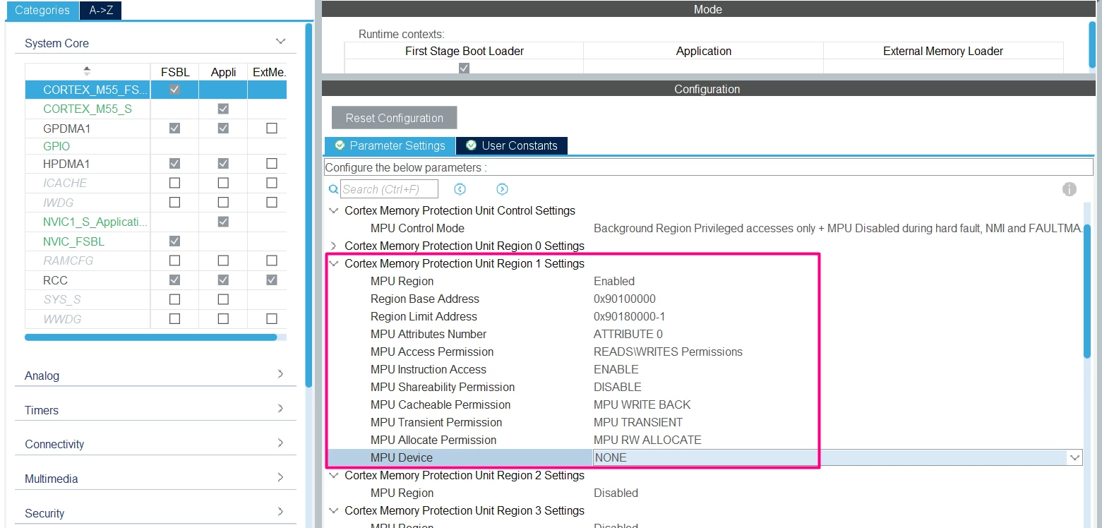

2.1.5 MPU Configuration
To avoid unwanted cache activity during the copying process, let’s configure the MPU for the external memories. Locate the [CORTEX_M55_FSBL] in the [System Core]. Enable the MPU Control Mode in [Background Region Privileged access only + MPU Disabled during hard fault, NMI and FAULTMASK handler]. If you need more details on MPU, please consider this article here.

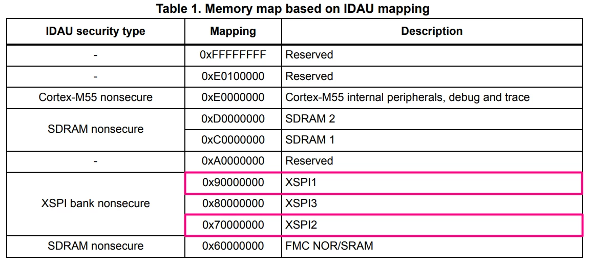

It’s worth highlighting this table from the reference manual, showing the mapping addresses for each XSPI:
With that information, along with the offsets used on the EXTMEM_MANAGER, add the MPU region for the external serial NOR FLASH and PSRAM. Starting with the serial NOR FLASH, which will be assigned to Region 0:
Add Region 1 for the external PSRAM:

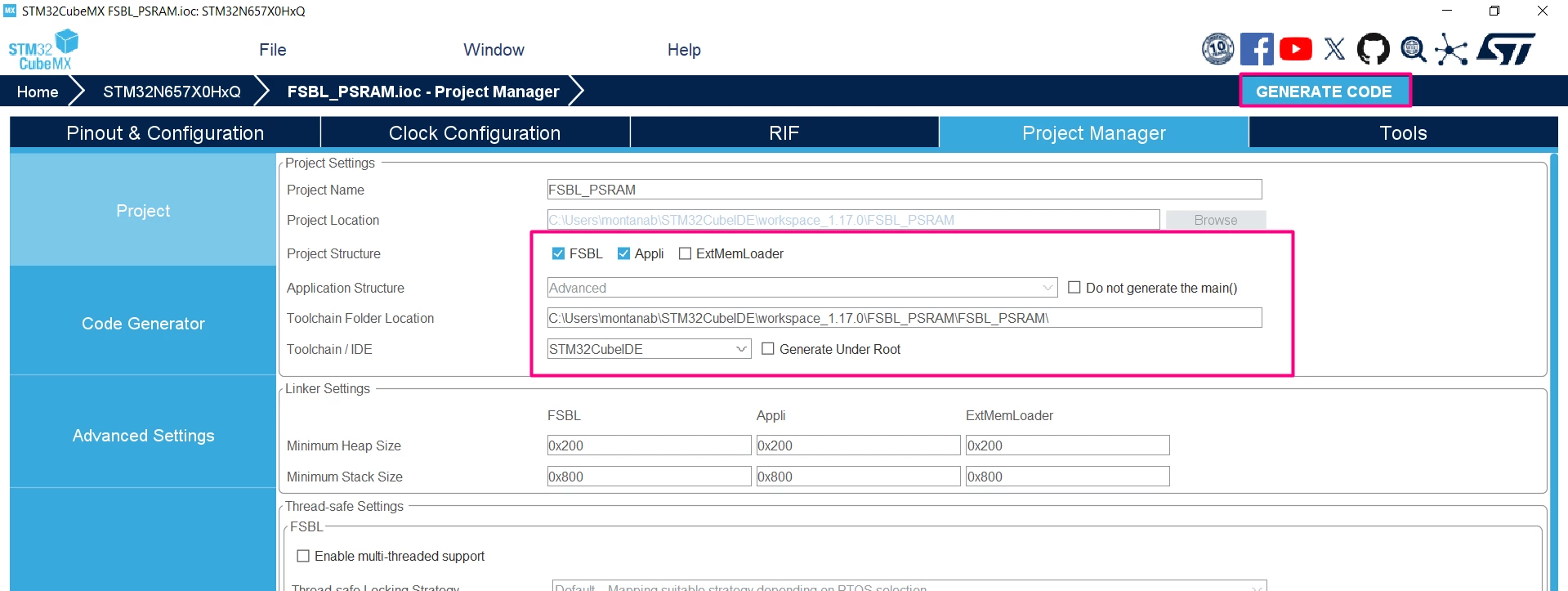

2.1.6 Generate Code
All settings are now completed and it’s time to proceed with the code generation for both projects:

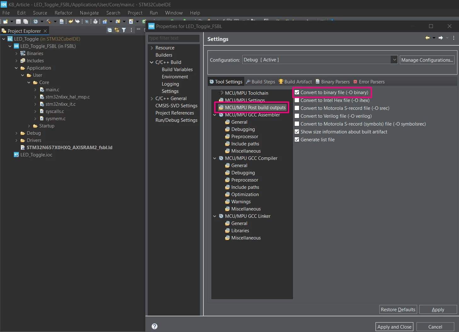

Make sure that your project settings are configured to generate the *.bin as well, since we’ll use it to run the scripts:

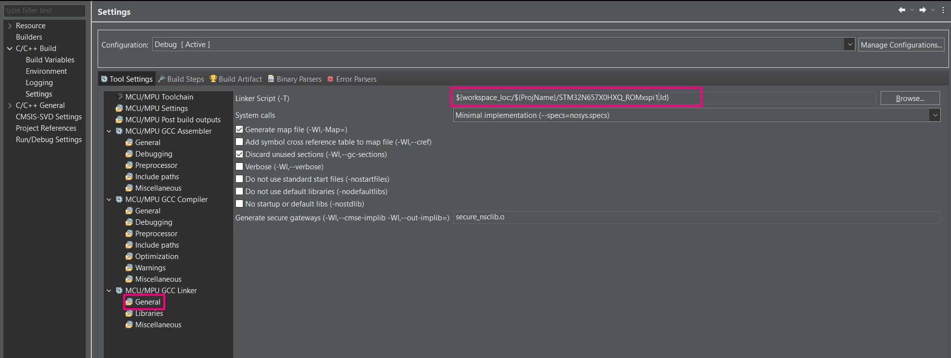

And change the default linker script that was made for the Load and RUN to the ROMxpsi1.ld. This can be done by locating the [MCU/MPU GCC Linker][General] and changing to STM32N657X0HXQ_ROMxspi1.ld

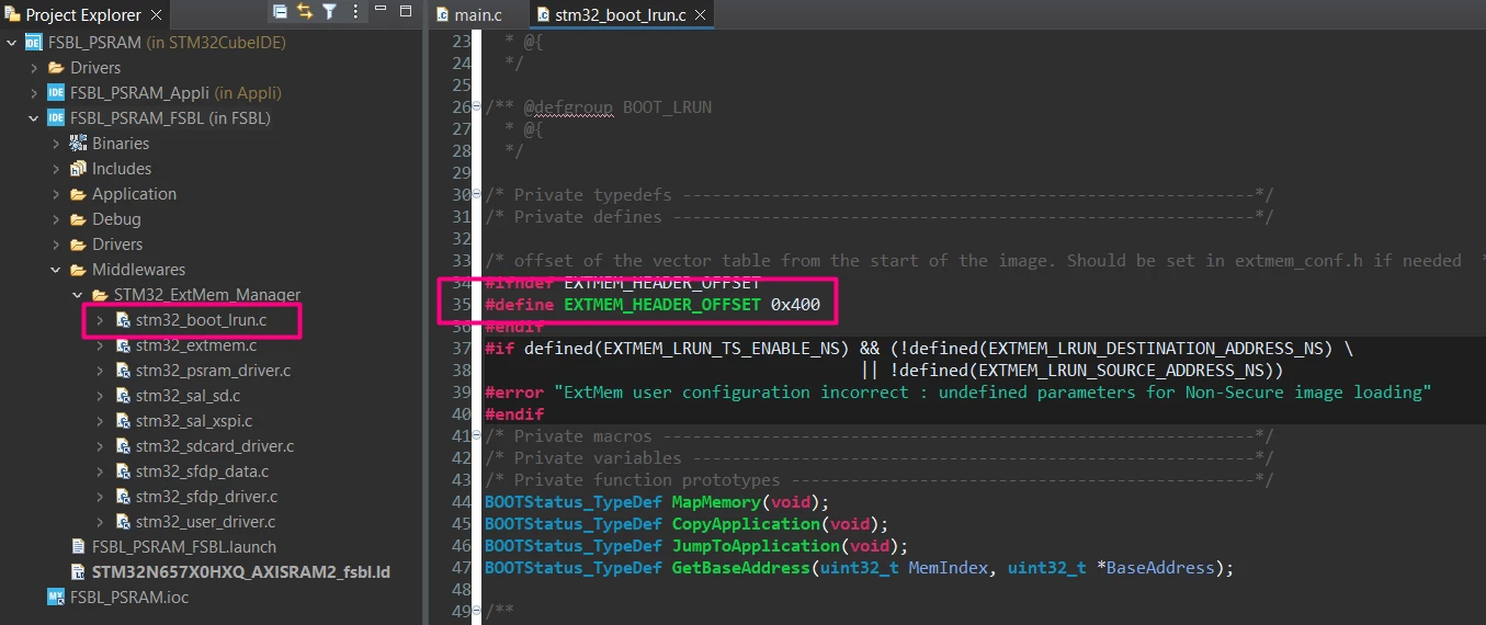

In the _FSBL project, locate the stm32_boot_lrun.c file and change the define [EXTMEM_HEADER_OFFSET] to be 0x400, since we’ll use the header script in the application as well.

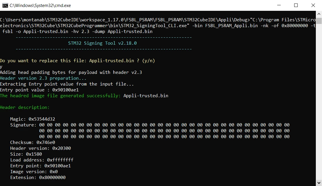

2.1.8 Adding the header
We need to add the FSBL header to ensure that the boot ROM is capable of reading and copying it from the external memory. Also, that the same header is added for the application. To do this, we use the STM32CubeProgrammer’s CLI. The next assumes the STM32CubeProgrammer was installed in the default path, if not, make sure to adjust it accordingly.
To facilitate the process, it’s possible to type “cmd” in the binary folder, for example: ..\STM32CubeIDE\Appli\Debug. This will pop up the cmd in the selected path.
Note that this process needs to be performed on the Appli and the FSBL projects, so here are the commands for each one, assuming the project name is FSBL_PSRAM:
After building both projects, make sure the *.bin will be created for both the _Appli and the _FSBL projects. Once the build is done successfully, we’ll perform the same step of calling the STM32CubeProgarmmer’s CLI in each of the binaries respective folder to perform the signing. Starting from STM32CubeProgrammer version 2.21.0 a new parameter is needed "-align". Please make sure you use the updated command, as follows:
FSBL:
"C:\Program Files\STMicroelectronics\STM32Cube\STM32CubeProgrammer\bin\STM32_SigningTool_CLI.exe" -bin FSBL_PSRAM_FSBL.bin -nk -of 0x80000000 -t fsbl -o FSBL-trusted.bin -hv 2.3 -dump FSBL-trusted.bin -align
Application:
"C:\Program Files\STMicroelectronics\STM32Cube\STM32CubeProgrammer\bin\STM32_SigningTool_CLI.exe" -bin FSBL_PSRAM_Appli.bin -nk -of 0x80000000 -t fsbl -o Appli-trusted.bin -hv 2.3 -dump Appli-trusted.bin -align
When issued, this is the expected output:

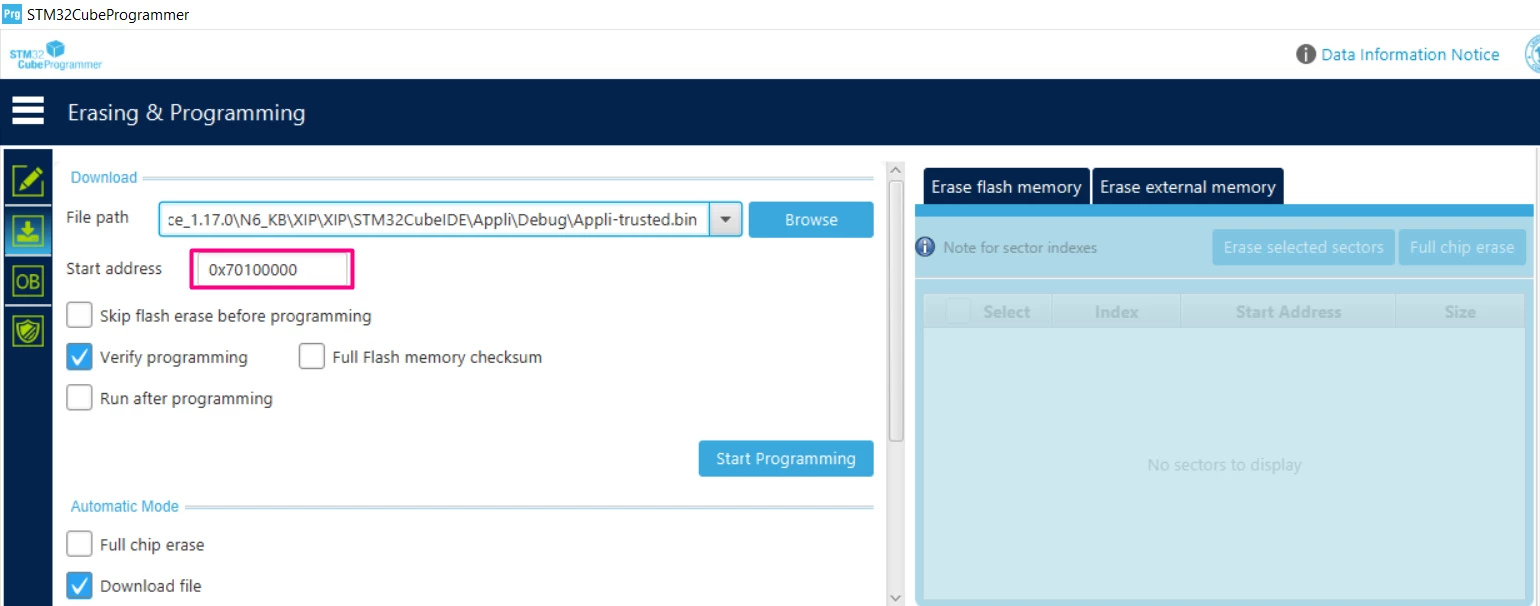

This will create the header for the binary, which can now be loaded into the external FLASH using STM32CubeProgrammer.

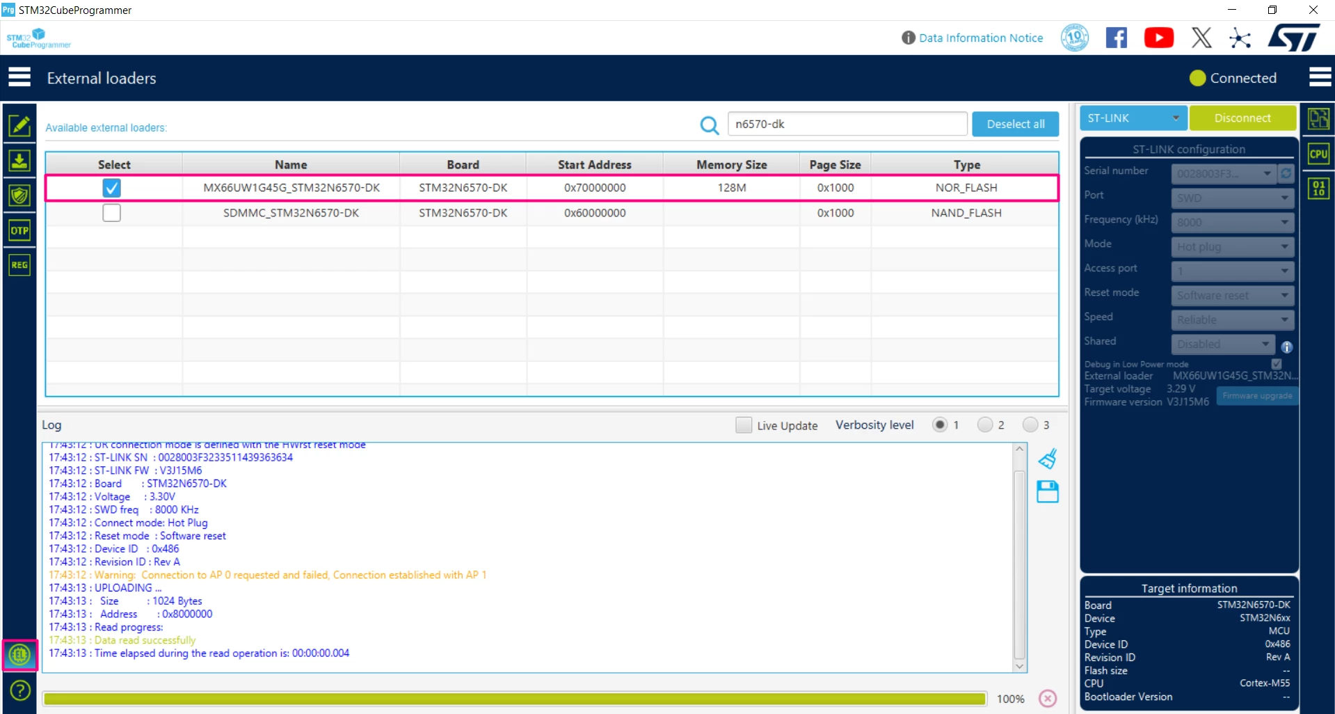

2.1.9 Programming the binaries
Make sure that the external loader for the flash memory is enabled:
And use the address [0x7000 0000] to program the FSBL binary and the [0x7010 0000] to program the application binary:
TIP: you might need to power cycle the board in case a failure message appears when clicking [Start Programming] and ensure it is positioned in DEV Boot mode.
