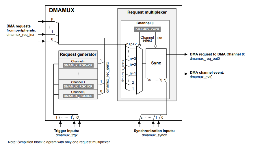

The DMAMUX request multiplexer enables routing DMA request lines from the peripherals to the DMA controllers in the products. The routing function is ensured by a programmable multi-channel DMA request line multiplexer. Each channel selects a unique DMA request line to forward (unconditionally or synchronously) to the associated DMA controller channel. This allows DMA requests to be managed with a high flexibility, maximizing the number of DMA requests that run concurrently.

This (and AN5224) is completely incorrect, because
  • in single-port DMA channels are 1-indexed, i.e. DMAMUX channel 0 corresponds to DMA channel 1
  • in dual-port DMA, indexing is OK but the transfer elements are called Streams rather than Channels
  • in some STM32 one DMAMUX serves several DMA units (e.g. in higher-end 'G0), i.e. the mapping is offset
I've ranted about this for years, e.g. https://community.st.com/s/question/0D53W000006s8dISAQ/dmamux-to-dma-channelstream-numbering-discrepancy, and while RM0440 I mentioned specifically there has been subsequently fixed, RM0444 for example does not mention the mapping not even in the incorrect way. I of course won't check all RMs containing DMAMUX (hence needing this subchapter) for ST. By now, I am tired by repeating the same thing again and again, just because ST "fixes" one particular "complaint/ticket" but can't communicate a broader issue internally.
That you magically fix it up in various Cubes is entirely irrelevant.
Btw. AN5224 is an opportunity to give an overview of all instances of DMAMUX and all mappings.
@ST AME Support NF​
@Imen DAHMEN​
MWagn.5
Thanks a lot. The fixed RM0440 saved me quite some time. Nether the less the DMAMUX chapter still is a mess. The difference between "unconditional request forwarding" and "conditional request forwarding" is not described. Without AN5224 it is really hard to understand the DMAMUX. Also Figure 32 of RM0440 is missing (page 428), which should be equal or similar to Figure 2 of AN5224 (or the second Figure on this page).
