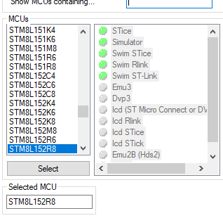

ST Visual Develop crashing and can't see programmer
Ironpretzel
Hello
The link provided on this solution is broken
ST Visual Developer says ''out of memory'' and cra... - STMicroelectronics Community
My tool is crashing every time I open Tool->Programmer
Also tools are greyed in MCU selection
I'm testing on Nucleo board NUCLEO-8L152R8
Drivers are installed and STVP can see the programmer. I have problem only on STVD.
I saw many post of it, is there any conf file for the workaround?
Thanks
1 REPLY 1
Ironpretzel
Found that
A fix consists in updating the file stvd/ProgrammerAddOn.dll to version 1.3.3.0 joined​
It worked.
