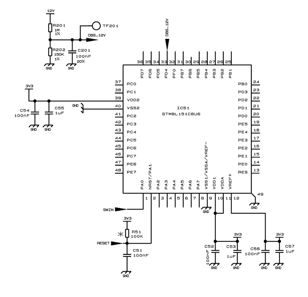

I'm trying to have the lowest consumption I can with a very simple design.
Weird thing appenened:
Putting PD4 in ''floating no interrupt'' mode, give me a definitely higher consumption than ''output pull-push low level'' mode (~150uA more)!

There is the answer:
CLK_PeripheralClockConfig(CLK_Peripheral_ADC1, ENABLE);
ADC1->TRIGR[2] = 0xFF;  // disable triggers
CLK_PeripheralClockConfig(CLK_Peripheral_ADC1, DISABLE);
