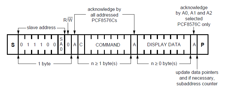

 I want to send below command with i2c but i cant do it. I use stm8s105c6 and i can send one data each start with i2c.0690X00000604r4QAA.png

I2C_GenerateStart(ENABLE);
while(!I2C_CheckEvent(I2C_EVENT_MASTER_MODE_SELECT));
  /* Send EEPROM address for write */
  I2C_Send7bitAddress(0x70, I2C_DIRECTION_TX);
  /* Test on EV6 and clear it */
  while(!I2C_CheckEvent(I2C_EVENT_MASTER_TRANSMITTER_MODE_SELECTED ));
  I2C_ClearFlag(I2C_FLAG_ADDRESSSENTMATCHED);
  /* Send Address (on 2 bytes) of first byte to be written & wait event detection */
  I2C_SendData(0xC8); /* MSB */
  /* Test on EV8 and clear it */
  while (!I2C_CheckEvent(I2C_EVENT_MASTER_BYTE_TRANSMITTING));
  I2C_SendData(0xaa); /* LSB */
  while (!I2C_CheckEvent(I2C_EVENT_MASTER_BYTE_TRANSMITTING));//////Stuck here my code
I2C_GenerateStop(ENABLE);
