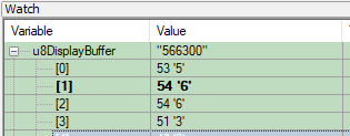

I'm using stvd and Cosmic (free) C compiler and I'm having issues with a simple statement. I'm using sprintf to conver two uint8_t to string but it always do it wrong.
uint8_t u8Hours = 22, u8Minutes = 31;
uint8_t u8DisplayBuffer[6];
sprintf(u8DisplayBuffer, ''%.2u%.2u'', u8Hours, u8Minutes );
the result is an array with ''5663''
I have tried everything on my mind but I can't figure it out what is happening, do you have some idea what can be wrong?

Try using an unsigned int
22 * 256 + 31 = 5663
unsigned int u8Hours = 22, u8Minutes = 31;
sprintf(u8DisplayBuffer, '%.2u%.2u', u8Hours, u8Minutes );
or
sprintf(u8DisplayBuffer, '%.2u%.2u', (unsigned int)u8Hours, (unsigned int)u8Minutes );

Hello Clive One, thank you very much for the quick answer,
I've tested with the type casts and it worked, thank you so much.
unfortunately I don't understand why, is there a short way to explain why it requires the conversion to 'unsigned int'?
Best regards, Mauro.
2017-09-26 7:08 PM
Because %u expects a 16-bit parameter, and apparently Cosmic folds 8-bit values.
The prototype for sprintf() doesn't infer any size on the parameters, thus no warning, or ability for the compiler to make better choices.
