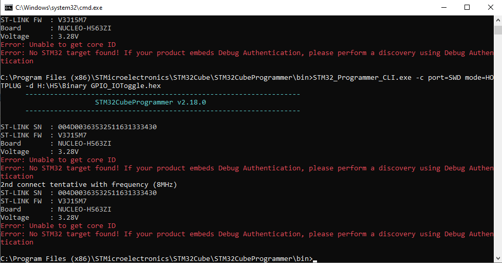

I am using Nucleo-H563Zi. Suddenly I got  "Error in initializing ST-LINK device" Reason: Unknown. Please check power and cabling to target. What I have tried to solve this:
. Connected pin BOOT0 and VDD and tried to connect to cube programmer.
. tried using power down and under reset mode to connect
none of the above helped me to connect and earse the full chip.
I have gone through every thread related to this problem but none helped. I have ran out of options. It would be great if someone assist me in this problem.Annotation 2024-11-27 182306.png

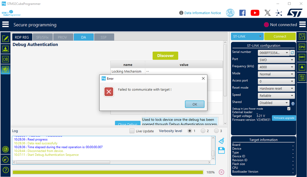

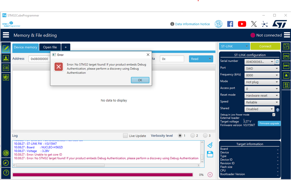

How is it possible to move forward when this kind of errors. Can't connect through CubeProgrammer and can't perform discovery. What might be the reasons or parameters that are causing this kind of errors?
Hello @jowakar122 ,
in here you show that you are able to connect with cubeprogrammer via GUI interface and show that you are in provisioning stat (value 17) .and now you are unable to connect, I don't get it what is really happening, is it the first or second case?
Regards
I am not able to connect now, earlier I was able to connect in HOTPLUG mode but now that is also not happening.
@STea Is there any other way to recover my device. I think it has been locked completely.

I tried the method you have mentioned but I got  this error:
Hello @jowakar122 ,
I think that you got the device bricked throw a combination of option byte settings that weren't supposed to be in the order you set them and thus you couldn't recuperate the device.
Regards
