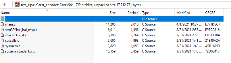

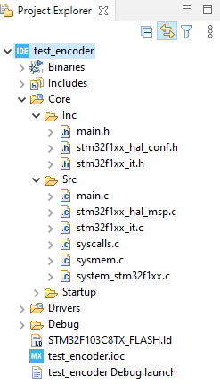

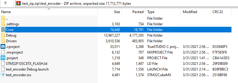

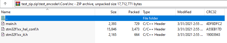

Can you be more specific? I use CubeMx 1.6.0 and the installed CubeMX 6.2.0 RC3 and I follow what you did. I mean I try to export in a zip archive one of my opened projects. I check to be all the folders marked and then I archive them. After that, I check the newly made archive and everything was there (.c files, .h files etc.).
Really I do not understand what are you guys trying to do?
Example given:
My project
0693W000008yyCiQAI.pngExported archive:0693W000008yyCxQAI.pngSrc folder content:0693W000008yyDRQAY.pngInc folder content:0693W000008yyDlQAI.pngAll of them are identical with coresponding files in my project. So, no problems at all.
Ok, people who don't have a problem have no complaints. People aren't complaining about things working as expected.
If the tools' not deleting your work that's great, for you, it doesn't really help diagnose the failing case.
However when the tools does delete things due to some corner conditions or broken logic, everyone has a bad day...
When the chance of failure is in the ppm, you give it to a few hundred million people, you're likely to see a few fail.
