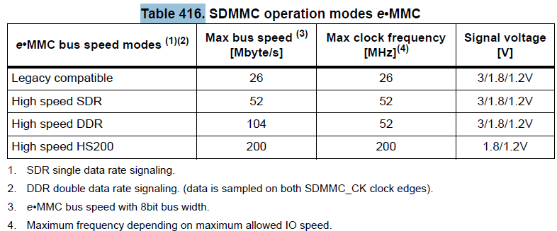

SMMDC mode is set according to the flash device and the expected speed .
All mode are not supported by HW (e.g. HS400 on eMMC)
The driver modes are defined in device tree file:
https://github.com/STMicroelectronics/linux/blob/v5.10-stm32mp/Documentation/devicetree/bindings/mmc/mmc-controller.yaml#L181
SDMMC_CK clock max frequency is in tables of RM0436rv5  "SDMMC operation modes"
 It is a maximum, so for example SDMMC in "eMMC High speed DDR" mode can have whatever SDMMC_CK frequency value between 0 and 52MHz.
In RefMan0436 tables present HS200, 200MHz is the max clock is defined here is from the JDEC standard .
On STM32MP1 there is limitation on SDMMC_CK for eMMC and SDCard: Max is not 130MHz but 100MHZ.
I/O max speed is the limitation.
