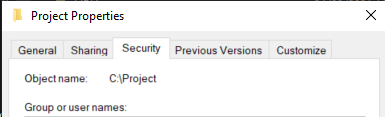

I'm having trouble creating a project in STMCubeIDE 1.7.0. I'm trying to create the project in it's own directory, instead of the workspace directory. The process I am following is: (continued below)
LThal.1
- Create the directory for the project (C:\Project)
- Create a New STM32 project
- Select the processor and package
- Setup STM32 project > Enter project name, for location enter project directory, select language and project type STM32Cube
- Code Generator options: Copy only necessary library files
When I start the project generation I get a popup message "C:\: Access is denied".
Using the "Project > Generate Code" option gives me the same message.
If I follow the same procedure and use the default workspace directory the project gets created successfully. Any suggestions as to how I can fix this problem would be appreciated.
Thanks
Lee

This is a question about windows, not the STM32MPU, and I'm not a windows expert, but if you are the admin of your computer, I think you just have to:
  • Right click on your Project folder
  • Click on "Properties"
  • Go inside Security tab
  • Then edit the permission for your user.
Hope it helps,
Regards,
Kevin

Kevin HUBER
Hello @Community member​ ,
Please can you try again inside another folder, not at the root of your Disk C.
For example in your "Documents" folder, the one in C:\Users\your_login\Documents.
It can be due to a problem of permissions.
Regards,
Kevin

LThal.1
Thanks Kevin,
I created a folder in the Documents folder and the project created successfully. What would I need to change in order to create the project in a new folder under C: ?

Kevin HUBER
Hope it helps,
Regards,
Kevin

LThal.1
I created the project folder under a new folder called "Projects". I also changed the security settings. One or both of these seems to have done the trick. I'm not going to worry about which one for now. Thanks for your help.
Regards,
Lee
