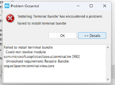

Hi there,
after last Copilot update inside IDE 1.19.0, I always have an error after the project is loaded:
After that the IDE close itself, a little window shows a message I'm not able to read (I think it is a update attempt, there is a red label on the bottom, too quick), and then everything is closed.
Please, I can i solve it ??

I found the c:\ST\STM32CubeIDE_1.16.0\STM32CubeIDE\configuration\1756799750460.log file that reports:
!SESSION 2025-09-02 09:55:50.216 -----------------------------------------------
eclipse.buildId=Version 1.19.0
java.version=21.0.3
java.vendor=Eclipse Adoptium
BootLoader constants: OS=win32, ARCH=x86_64, WS=win32, NL=it_IT
Command-line arguments: -os win32 -ws win32 -arch x86_64
!ENTRY com.microsoft.copilot.eclipse.ui.terminal.tm 4 0 2025-09-02 09:55:51.033
!MESSAGE FrameworkEvent ERROR
!STACK 0
org.osgi.framework.BundleException: Could not resolve module: com.microsoft.copilot.eclipse.ui.terminal.tm [991]
 Unresolved requirement: Require-Bundle: org.eclipse.tm.terminal.view.core

-- ADDED 2 --
How can i remove the pluginin manually ??
I removed all the com.microsoft.copilot.* under plugin folder but it is not enough, the IDE crashes, without message.

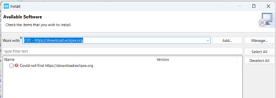

September 25, 2025
I have got the same error and I fix it by install "terminal features", following these steps:
go to:
help--> install new software
then type "https://download.eclipse.org" in "work with" textbox.
You should select "Remote services" items, then click on "next" button and follow the installation steps.
Sebastiano
SteMMoAuthor
September 25, 2025
Thanks for reply.
If I type the link I have:
Ste
Luka_0v0Best answer
Visitor II
October 10, 2025
Got the same probelm. But I found the following link works for me:
CDT - https://download.eclipse.org/tools/cdt/releases/latest
