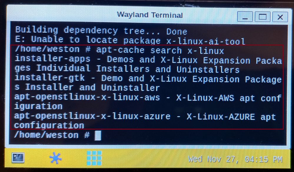

Hallo, thank you fior the answer. You were right with the lastest package, I had an old one, from previous year. So, the first thing I did was loading newest version of image. The tsv file was:
FlashLayout_sdcard_stm32mp135f-dk-optee.tsv
Next, command: apt-get update was ok.
Next, command: apt-get tinstall x-linux-ai-tool gave message: Unable to locate package x-linux-ai-tool,
so the next step was to run command: apt-cache search x-linux, te result was:
So, maybe now is the place to do next steps... I would be greatfull for your advice.
regards, Paul

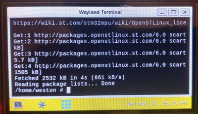

Thank you for quick answer. The response looks almost the same. Details below...
Regards Paul.
Hi @PawelKan
Your image is based on OpenSTLinux ecosystem 6.0
X-Linux-AI packages are not yet available for this ecosystem.
You can check with the OpenSTLinux ecosystem 5.1 and get the expected results.
