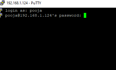

i am using stm32mp135-dk board i am install the  STM32MP1-Ecosystem-v5.0.0 Starter Package
 now i want to connect the board with my laptop using putty software ,i have the ip address of the board but did't have the password of the board. what will be the default password??
PatrickF
Hi @Pooja321 ,
On Starter package, only 'root' login without password is available for ssh.
https://wiki.st.com/stm32mpu/wiki/How_to_perform_ssh_connection
If you added other users, you should know the password you have used.
