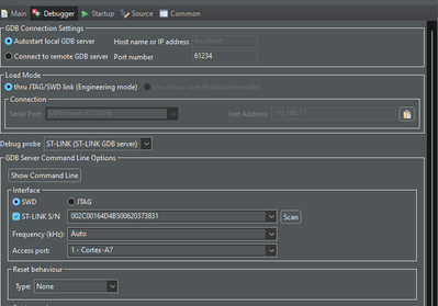

In debug configuration, tried selecting Debug Probe ST-LINK GDB Server
Those are the debug configurations:

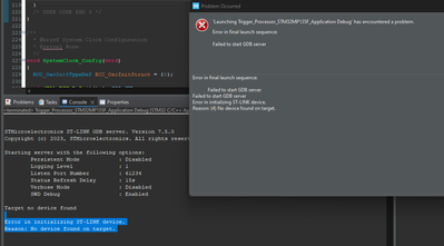

I get the following message:
"Failed to start GDB server. Error in initializing ST-LINK device. Reason: (4) No device found on target."
Tried in ST-LINK GDB Server mode to change the Reset Behaviour, modify the frequency, didnt help.

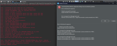

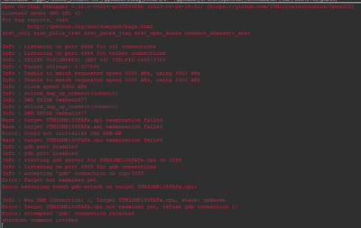

Tried Debug Probe ST-LINK(OpenOCD) with the following configuration:
I get the following text:

I still get the following error:
I would very much appreciate any assistance.

Hello @robbie-galfrin ,
You tell me in your first message that all boot pins are at 0. But it should not. It should be in engineering mode, with boot pin number 3 toggled. It is precised in the first chapter of the article I mentioned in my message. Can you test again the steps of the article with using this boot mode ?
