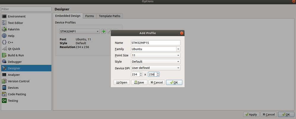

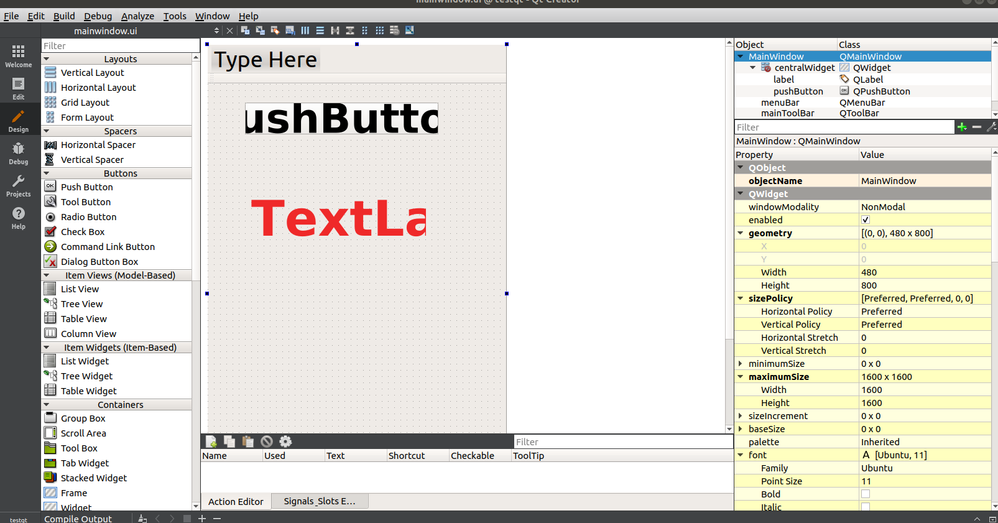

I create a QT project and run it on the board STM32MP157C-DK2  with command " /tmp/testqt/bin/testqt". The data display on the DSI display is mismatch my testing project's UI.
LCD_picture.jpg is DSI display data.
QT_UI.jpg is Qt project's UI.
Please advise how to solve it.

Hello @zqizh.1​
Finally, your problem comes from a configuration of QtCreator itself. You need to configure the resolution of the target of the Designer tool.
How to do that ?
In QtCreator, go to Tools -> Options -> Designer -> Embedded Design.
Here you will create a new Device profile that will deals with your real target resolution. In the case of the native screen of the STM32MP15, we have something like 234 x 236 dpi.
0693W00000JPtgcQAD.pngThen you will restart QtCreator (it seems that it needs it to reconfigure the preview). And now the preview is in phase with what you can observe on your target:
0693W00000JPtiOQAT.pngNow you can adjust the font size of the QButton and the QLabel properly depending of what you want.
Hope it will help you.
Regards.
Erwan.

My LCD resolution is 480X800, and I configured the UI's geometry parameter to [(0,0),480x800]
