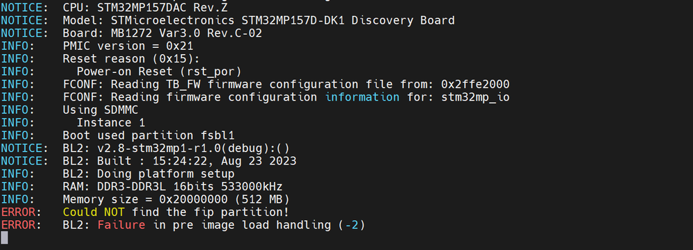

Hi community,
I am attempting to compile TF-A in a straightforward manner, similar to ecosystem v2, which packs BL2 & BL32 to only one single .stm32 file for writing to fsbl1/fsbl2.
However, FIP is enabled by default in ecosystem v5. I am curious about how to disable it?
Ecosystem v3 release note mentioned that it can be done by setting MACHINE_FEATURES_remove = "fip", but I cannot find the config file.
