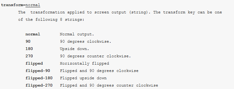

I'm making custom board ​with stm32mp157AAA.
lcd works nomally, but i want rotate this to 90.
Please help me.

Hello @DLee.15​
I don't know if you are still trying to rotate your screen, but the section that must especially interest you in the link provided by @Community member​ is:
https://wiki.st.com/stm32mpu/wiki/Wayland_Weston_overview#Configuration

Hi @DLee.15​ ,
If you are using weston wayland please have a look to :

Hello @DLee.15​
