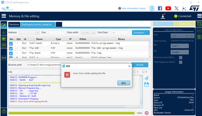

Hi everyone,
I am encountering an issue while trying to flash OpenSTDroid onto my STM32MP257F-DK board.
I downloaded the Starter Package from the official website and used STM32CubeProgrammer for the installation. However, the flashing process consistently fails during the final stages.
Could anyone provide the correct flashing procedure or suggest what might be causing this error? Below are the details of my setup:

Hi Steven
I tested again the download of the last OpenSTDroid starter image with STM32CubeProgrammer v2.21 on the STM32MP257F-DK board. I don't see any problem on my side.
I understood that the error occurs at the end of the super.img download, right ? It's similar to an issue encountered on an old version of STM32CubeProgrammer. Can you try again with the latest (v2.21) ?

Thank you. I have successfully flashed the image using STM32CubeProgrammer v2.21.
