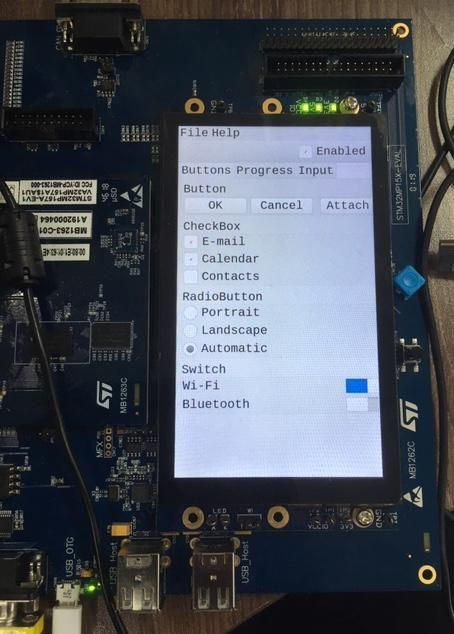

But I'm having a hard time. When running the Qt example, it is running in portrait mode only, not landscape mode. How can I run the Qt example in landscape mode? To run in landscape mode, I tried two things.

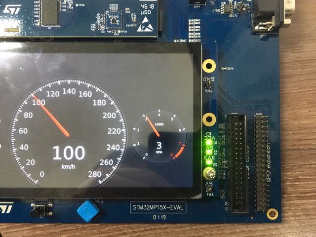

The first method was useless. The second method was displayed in landscape view as shown in the following image.
