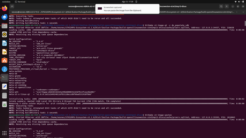

2024-08-13 11:36 PM - edited 2024-08-14 12:39 AM
@Erwan SZYMANSKI I encountered this problem when ı was trying to add an example qt application to the board. when ı build my distributions packet ı didn't have any problem, flashing the board works nicely but when I added the
IMAGE_INSTALL_append = " qtbase qtdeclarative qtwayland qtimageformats qtmultimedia"
line to my local.conf and built st-image-weston again after flashing the board nothing works even the simple ls command. I couldn't understand the problem.

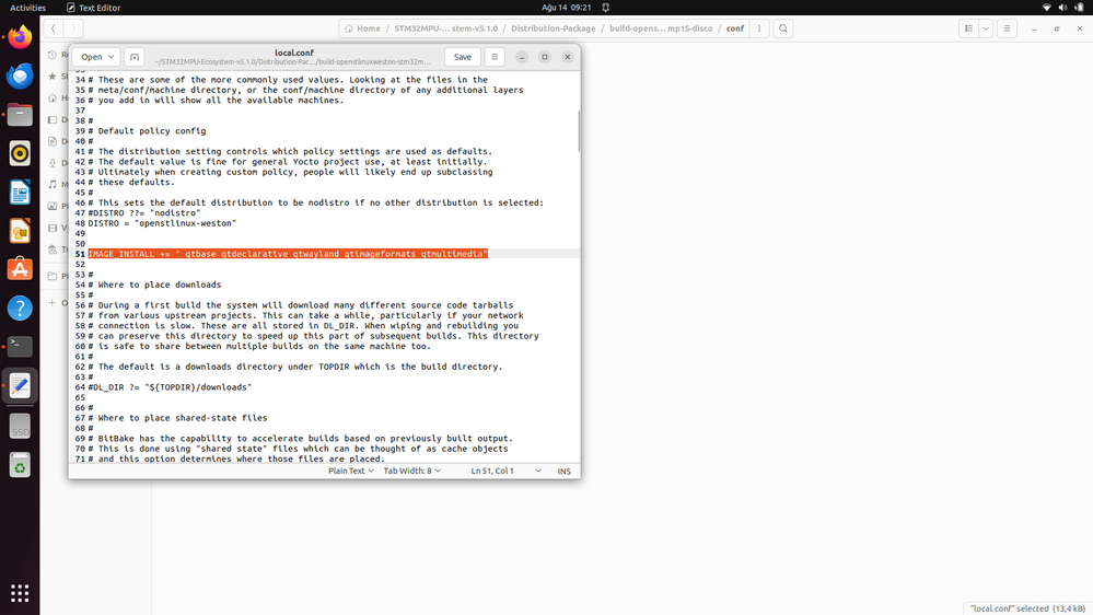

2024-08-14 3:41 AM - edited 2024-08-15 4:04 AM
I write in the right syntax when writing local conf like in the last picture.
When I build the distribution package, everything works fine, and the image flashes to the board without any issues. However, after I add the line
IMAGE_INSTALL += "qtbase qtdeclarative qtwayland qtimageformats qtmultimedia"
to the local.conf file and rebuild the st-image-weston, the number of files in the build drops from around 8000 to 5000. Although the build process doesn't throw any errors, when I flash the board with this image, it becomes stuck on the boot screen, and no commands, not even ls, work. Why could this be happening?
Instead of adding them in IMAGE_INSTALL += should ı do something else to add them to my image ?
The reason why I am trying to this is that I just want to learn how add my example qt application to my board (with adding to my image with my own layer without licensing ) .
2024-08-14 5:10 AM
@nesnes ,
Just by looking at your issue like that, I do not have a lot of idea.
What is sure is that the "_append" will do absolutely nothing.
Maybe try to add a space after your qtmultimedia " in your IMAGE_INSTALL line. Yocto will just concatenate the variable and so maybe something is going wrong, but I am not sure about that.
If it does not correct anything, I advice you to restart from scratch, with the default Distribution Package we provide that works, then step by step add your part inside and see what provoke the bad situation.
Kind regards,
Erwan.

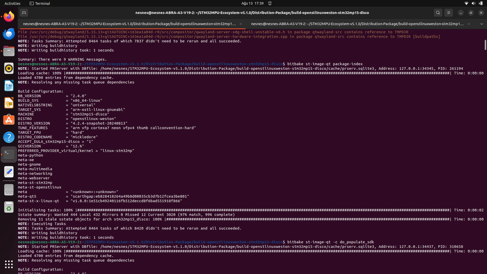

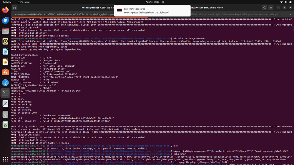

2024-08-14 5:18 AM - edited 2024-08-14 5:18 AM
@Erwan SZYMANSKI I did restart from scratch, with the default Distribution Package and it works fine , but it doesnt work when I add
IMAGE_INSTALL += "qbase"
when I add this line Tasks Summary: Attempted 7925 tasks dropping to 5555 and when I try to flash , I do it without error but yocto doesnt work on the board.But when I remove the line it works nicely again.
2024-08-14 5:24 AM
@nesnes ,
Above I told you about the space and the concatenation in this variable, I would like to see space before and after qtbase : IMAGE_INSTALL += " qbase "
To be sure, use the following syntax :

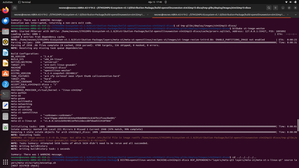

2024-08-14 10:57 PM
@Erwan SZYMANSKII did try it with those syntax nothing changed.
2024-08-15 6:05 AM
@nesnes ,
Like this, I do not see what happens. If Yocto consider he has less tasks to do, in a way or another, something remove some packages to deploy in the final image, that can explain why you see some things missing when you boot up the board.
But without your complete setup, I will have some trouble to help more.
Can you explain from the very beginning the step you follow ?
Kind regards,
Erwan.
