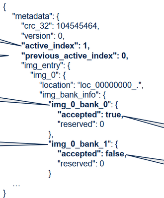

Hello
I am working on the multi-system in STM32MP257-EV board, I had modified the tsv file to prepare a double system A and B. If using the default metadata.bin file, the A system will be run always. Now I want the B system to be run, I need to modify the metadata.bin file, for example change the "accepted" of B bank to false:
If the status of img_0_bank_1 is trial, the B bank system will be run when ev board power up, isn't it?
how to modify the metadata.bin?
If the status of img_0_bank_1 has been modified to trial, and the B bank system run up normally, is the status of img_0_bank_1 modified automatically by linux? how does the linux system modify the metadata.bin file?

Then, I use the fwumd_tool.py tool in tf-a transfer bin file to json file:
./fwumd_tool.py binparse ~/metadata_tool/metadata.bin -j ~/metadata_tool/metadata.json
Then, cat it to check if the status of bank changed or not, and it looks like the new tool not work:
cat ~/metadata_tool/metadata.json
"metadata": {
"crc_32": 3929930603,
"version": 2,
"active_index": 1,
"previous_active_index": 0,
"img_entry": {
"img_0": {
"location": "loc_00010002_0050_0018_83df_d519b0117b45",
"img_bank_info": {
"img_0_bank_0": {
"accepted": true,
"reserved": 588097189
"img_0_bank_1": {
"accepted": true,
"reserved": 0
@longfeili_00001,
The tool named fwumd_tool.py is only compatible with metadata v1.
The tool named mkfwumdata is only compatible with metadata v2.
Here, you used fwumd_tool.py with metadata v2.
To check if the metadata is well built with mkfwumdata, write the generated file into metadata partitions, are reboot the platform to check the impact in TF-A.
